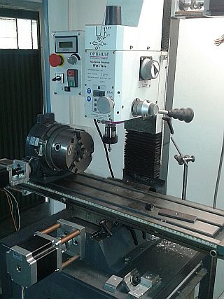

My problem is that A axis when is on 359 degree and next is 0 is turning back.
Is there any option to say that came to next value in shortest way?

It is for a toolchanger?
If so, we implemented several of them using a component and not treating the A like an ordinary axis. It works well.

Possibly WRAPPED_ROTARY.
www.linuxcnc.org/docs/html/config/ini_co...tml#sub:AXIS-section
