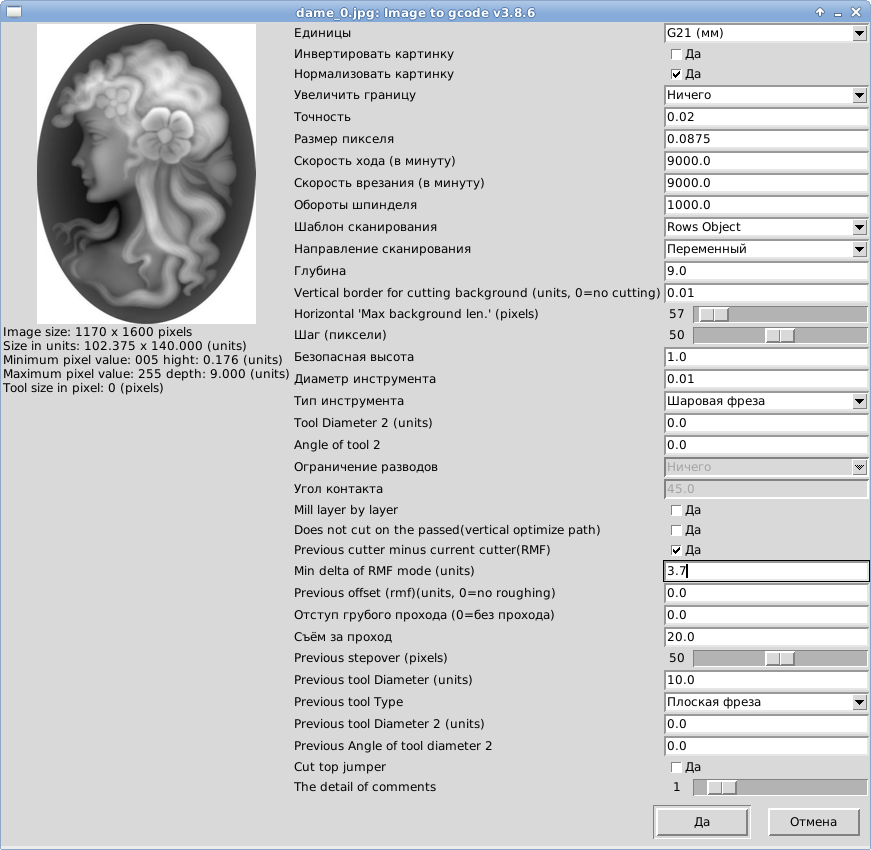

I was refactoring code in python scrypt image-to-gcode.py. (I work this 1,5 years :blush: .)
File Attachment:
File Name: image-to-g...v3.7.zip
File Size:22 KB
2014-12-26 - new ver 3.8.7
File Attachment:
File Name: image-to-g....8.7.zip
File Size:25 KB
I expanded functionality. Added 2 mode "Rows objectiv" "Cols objectiv" and some other functions.

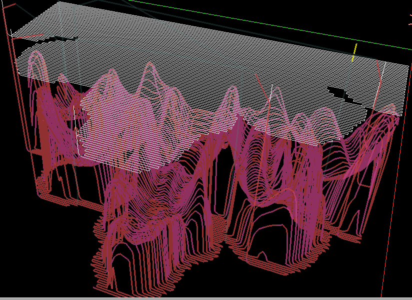

25 Jul 2014 13:30 - 25 Jul 2014 13:49 #49116 by Harmonist
<jepler> the code's not obviously terrible
This is my first work on Python. In processing a serious bug: it uncontrolled eating memory (for large pictures 4000x2000 - eaten 1.5GB memory). Somewhere I do not clear the memory ... I would be grateful if someone would find this bug and fix it.
<BigJohnT> So, would you like to be the new maintainer?
I am very pleased your suggestion, but unfortunately I ran out of gas.
During development I understood almost everything code (except for a pair of functions), and now I see a lot of flaws that (I think) can be eliminated only by creating g-code for 3d models.
Some of the most significant are:
- To increase the accuracy necessary to increase the size of the image, while increasing the size of the image - growing time "compilation" g-code.
While CAM has turned very functional. It has the features that I have not seen in traditional CAM. I think using the image-to-gcode can even get 3d model - without turning preform from different sides, but only by making rotation axis Y.
I plan to describe the basic algorithm that I developed in the pictures, that any developer understands how it works and could freely continue improving the image-to-gcode or its CAM ...
This is the algorithm that makes the g-code only in those places where it is not included roughing cutter and depth of these locations exceed the maximum permissible maximum. Only in such places formed g-code for fine milling at a predetermined pitch penetration. It is necessary to thin cutters that can break down these locations - if this location does not pass layers but at one time.
(Because many CAM is no such algorithm - not to break the cutter users are layers - all the model - which increases the receipt of the product at times.)
With a little refinement can be done to to fine milling formed g-code in one pass, but when you approach these "narrow" and "deep" places pictures - special g-codes - to reduce movement speed by XX% ...
I think it is undertaken for the project BlenderДAM. This (free) plug-in for Blender for make g-code.
Now I understand a set of approximation points NURBS splines to modify another script called LinuxCNC autors.py. This script makes g-code (arc and lines) on the set of points, which gives him the image-to-gcode. But the quality of train code does not suit me: geometric lines it does well, but the model with smooth lines - if you closer the g-code in LinuxCNC - you can see the following ...
I plan to make a set point optimization algorithm instead of Douglas-Peusker - NURBS spline approximation algorithm described in documents "Optimal Single Biarc Fitting and its Applications" Hyungjun Park and papper "CAD/CAM interpolation for NURBS path interpolation on PC based real-time numerical control" by M.Leto, R.Licari, E.LoValvo, M.Piacentini...

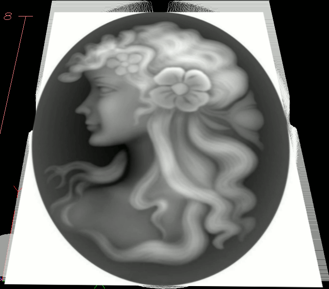

25 Dec 2014 21:28 - 25 Dec 2014 21:36 #54304 by Harmonist
new ver 3.8.7 - look on top post
for comparison - I made in Gimp this picture to show that the regime RMF - is something else than just filter depth images
Function Optimize path:
Last edit: 25 Dec 2014 21:36 by Harmonist. Reason: add some comments
