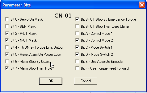

Some preliminary information to keep you busy:
From the .YPM file
Most important settings are:
CN-01, bits A-D: these setup the drive in torque mode.
CN-13: this sets up the scale of the incoming torque command. Now it is 3 Volts for 100% torque. 9 volts will do 300% torque.
CN-14: The maximum speed you allow the motor to run at when in torque control mode. You can go up all the way to 4500rpm if you desire. I have no use for anything above 3000rpm.
CN-17: the torque filter time constant. I set this as fast as possible to tighten up the loop. If you have noise in the system you must slow this down.
CN18/CN19: during initial testing and first time running you might want to set this to a low value, 50% or so. A 400W servo motor at full peak power going out of control is a scary thing...
The rest of the parameters affect the internal speed control loops, which I disabled by selecting torque mode.
Part of the INI file that is different from a regular setup::
Snippets of the HAL file that does the servo stuff:
Entire .INI file
Entire .HAL file
Please keep in mind that the mill is not finished yet and the INI/HAL files are still a work in progress.
I'll check for some of the notes when I am at home.
From the .YPM file
