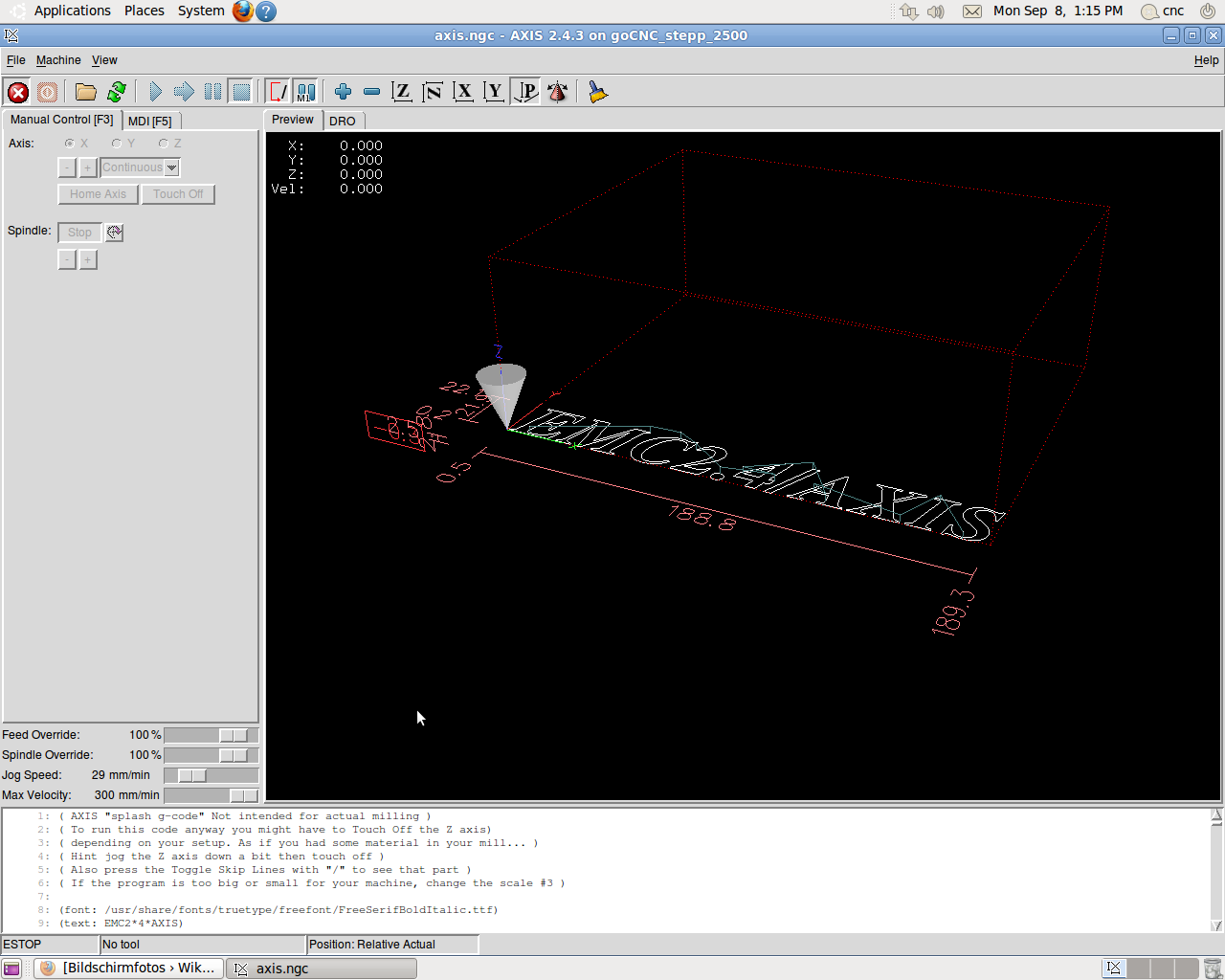

- seiringerf
- Posts: 4
08 Sep 2014 16:30 - 08 Sep 2014 16:48 #50911
by seiringerf
Replied by seiringerf on topic Need help, please: EMC2 is will not open.
Hallo ArcEye,
i think you don't know me, but i have read here about this Problem for starting the cnc-machine,
and maybe you can help me -> i would be very grateful
Am going to work with this machine: gocnc.de/index.php?page=product&info=184
So i have already done the EMC2 Stepp configuration and it is possible to move the three axis with the "test axis" buttons.
When i am going to run my Configuration "goCNC Stepp 2500" i also get an error message
-> Could not open command file 'GoCNC'.
I send you the hole error output in the notes! If it is necessary i can also send you the screenshots of my configurations!
So i would be very glad to get an answer from you! Sorry for my bad english
Wish you a nice day ... and thanks in advance!
Franz
Franz
Last edit: 08 Sep 2014 16:48 by seiringerf.

- ArcEye
- Posts: 24
- Thank you received: 758
08 Sep 2014 17:13 #50918
by ArcEye
Replied by ArcEye on topic Need help, please: EMC2 is will not open.
The instructions are here: www.digi-vision.de/pdf/EMC-Kurzanleitung.pdf
I translated them, nothing out of the ordinary, we need to see the configs as cncbasher said.
The warning probably comes from line 216 (in my copy) of halcmd_main.c, which would indicate that it cannot find the .hal file that is
listed in the .ini file (either not present or name different?)
regards
regards
- seiringerf
- Posts: 4
08 Sep 2014 17:30 #50923
by seiringerf
Hallo,
thank you both (ArcEye & cncbasher) for the quick response!
I have placed the whole configs folder as an attachment to my my post! Maybe you will get more informations from this!
I will also try now the instructions as ArcEye send me in the link!!
Thank you very much!!
- ArcEye
- Posts: 24
08 Sep 2014 17:55 - 08 Sep 2014 17:55 #50924
by ArcEye
A very brief look shows that you have spaces in your .ini and .hal file names
Linux does not do spaces in file names very well
I have added underscores instead
Try it now
regards
Try it now
regards
Last edit: 08 Sep 2014 17:55 by ArcEye.

- seiringerf
- Posts: 4
08 Sep 2014 18:36 - 08 Sep 2014 18:40 #50931
by seiringerf
Hey you two,
i think it's working, there is no Error message anymore !! I am really happy now
I have already invested much time, and searched on other internet sites to solve the problem,
but you really helped me now !!
I would like to drink a beer with you now
So in the notes i send a screenshot to you, to see how it looks like now!! ]
I am a real beginner by working with a cnc machine, but i am looking forward to get it started!
Now i have to study how it works with the g-code and so on, i hope i will be able to ...
Maybe i will write you again, i hope you will help me again if it is necessary!!
@ ArcEye: I think the spaces like you say have been the problem! Thank you!!
@ cncbasher: I am using the standard software of the seller "linuxCNC 2.4.3 and the newest version of ubuntu, but it does't matter now i think.
greetings
greetings
Last edit: 08 Sep 2014 18:40 by seiringerf.
