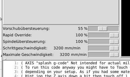

15 Nov 2014 17:38 #53110 by kaher
Dear Members
I am using ubuntu with 2.4 linuxcnc all work fine but i think now it is time to update hardware and renew linuxcnc
now i have try out the new debian with the 2.6 linuxcnc on my new computer and there are no problems and all work fine
only a little thing is verry confusing me
is there a reason to get the slider for Normal Feedrate and Rapidfeed to one togehter i misslike that and ouccurs some hardwarecrash
when i have finish my rebuld of machine i will use only one knob to set the feed
i will do this later on paraport 2 with 2 inputs and an optical 100 cpr encoder (comes when it is clear that i will be able to to for an Noob)
i must sy i have no expirience in programming computers and need there a big helping hand to finish all
as first is there a reason to get one slider for all feed?
thank you for your help and greetings from styria
Karl
15 Nov 2014 19:27 #53114 by ArcEye
Hi
This was deliberate.
There was a lot of discussion about whether feed override should affect rapids and the consensus was that it should not.
Especially you should not be able to increase rapids to 120%, when that speed should already be at the optimum maximum for the machine
Just one discussion
sourceforge.net/p/emc/mailman/message/31438983/
search the mail lists for more info
The solution appears in 2 sliders so that normal G1 FXX feed override does not affect rapids, but allowing G0 rapids to be to be reduced if required without requiring a shut down and editing of the .ini file

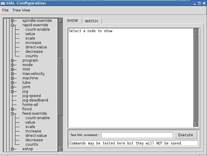

16 Nov 2014 01:42 - 16 Nov 2014 01:49 #53128 by dgarrett
Example to tie the axis ui feed-override slider to rapid-override
Create a new file named try.hal in your directory containing axis.ini
# try.hal: connect feed-override to rapid-override
loadrt conv_float_s32 names=cv
addf cv servo-thread
loadrt scale names=sc
addf sc servo-thread
setp halui.feed-override.direct-value 0
setp halui.rapid-override.direct-value 1
setp halui.rapid-override.scale .01
setp sc.gain 100
net sig1 halui.feed-override.value => sc.in
net sig2 sc.out                    => cv.in
net sig3 cv.out                    => halui.rapid-override.counts
To test, edit your axis.ini file to add line as shown:
[HAL]
HALFILE = core_sim.hal
HALFILE = sim_spindle_encoder.hal
HALFILE = axis_manualtoolchange.hal
HALFILE = simulated_home.hal
HALFILE = check_constraints.hal
# !!!!!!!!!!!  add this line:
HALFILE = try.hal
Last edit: 16 Nov 2014 01:49 by dgarrett.

16 Nov 2014 21:28 #53136 by dgarrett
You are trying to load two scale components one using count= and one using names= which is not allowed
grep "loadrt.*scale" *.hal
machine.hal:loadrt scale count=1
try.hal:loadrt scale names=sc
but the first one is not used in the hal files posted:
$ grep "scale.0" *.hal
machine.hal:addf scale.0 servo-thread
So you can remove it (comment out with leading #] like this in machine.hal
# NOTUSED loadrt scale count=1
# NOTUSED addf scale.0 servo-thread
and try again.
You will benefit from a study of linuxcnc.org/docs/html/hal/basic_hal.html
