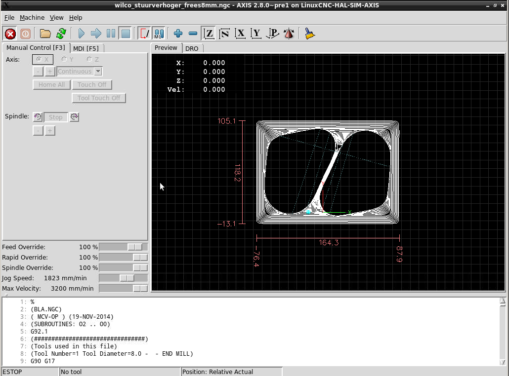

So, I am having problems with the preview om my machine running the real configuration. The Y axis is stretched:
This is not gmoccapy-related; when I switch the display to AXIS it shows the same behaviour.
In a simulation configuration (sim.axis/sim.gmoccapy) the preview is OK:
When I fire up the configuration of my BF20, which is a parport driven stepper machine, the preview is OK too. Of course that configuration does nothing when run on the current Mesa-driven machine, but at least it is a realtime configuration.
The machine is running Lubuntu 12.04 with 3.4.55-rtai kernel (i set that up before the Debian-based distribution became available) and a RIP build of 2.8.0~pre
I am not sure when this issue started. I only started using the machine a couple of weeks ago so it has probably been present for a long time but I just did not notice it because I did not load G code programs before.

- Posts: 23377
- Thank you received: 4966
01 Dec 2014 01:42 #53545
I don't know what the cause is, but it is almost certainly nothing to do with HAL.
Do the parts come out correctly?
Replied by andypugh on topic Preview wrong on my machine: Y axis is stretched
I am at the point that only the servoloops are left in the HAL file using only LinuxCNC-supplied RT components. Tearing those loops down is a lot of work, so I though I could better ask here before doing so...
Any idea what might cause this?

01 Dec 2014 02:19 #53548
by DaBit
Replied by DaBit on topic Preview wrong on my machine: Y axis is stretched
Yes, milling itself is flawless and the parts come out correctly.
It is only the preview that fails. And more specific: only the backplot, only in the Y direction, and independent of the GUI chosen (although I only tried axis and gmoccapy). The 'size bars' seem correct and at the right place. It also does not matter what kind of G-code generated the backplot; CAM-generated code with only G0/G1 lines is just as incorrect as handwritten code containing a couple of arc segments or G8x canned cycles. Circles become ovals.
I do not suspect HAL either, but it is still strange that a sim config or parport config works fine, but the 6i25 + 7i77 + PID loops config does not. There is a relationship. The problem is that I have no idea how to proceed in troubleshooting at this point without firing loose bullets and hoping to hit something.

05 Dec 2014 22:13 #53718
by DaBit
OK, I got tired of it today and decided to install a fresh Debian Wheezy next to the existing Ubuntu 12.04.
That did not solve the problem; preview stayed stretched.
Upon close review of the INI file I found this:
The 'GEOMETRY=XYYZ' was remaining from the time when I setup the machine with gantrykins. Now I use it as a regular 3-axis machine and the second Y joint is dealt with outside the kinematics.
Change it to 'GEOMETRY=XYZ' and the preview is correct again.
I think that is a bug, BTW.
