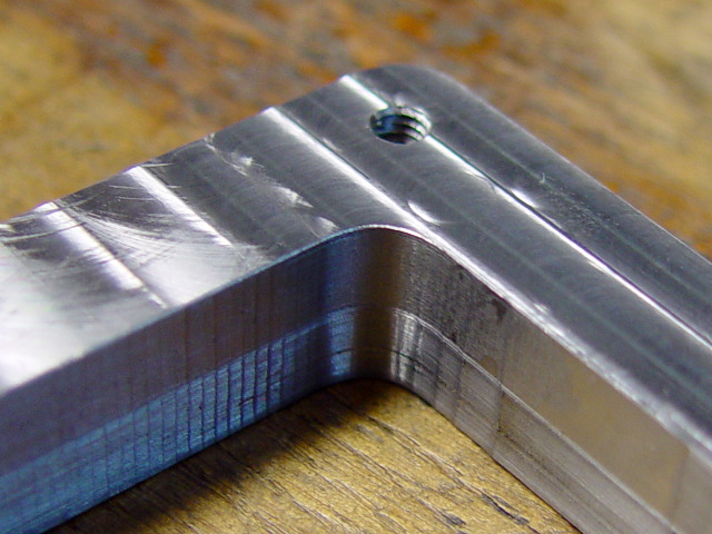

Has anyone seen this before?
My mill tends to mill facets on arcs, but only does so during G2 arcs.
Climb milling. Inside corners are fine:
Outside corners, not so:
The above two pictures were already from a slower run (850mm/min, 6500rpm on a 6mm carbide endmill) where following errors stayed below 0,02mm.
The initial run was much faster: 11000rpm, 1900mm/min. Facets are the same, so I doubt it is servo-related. I also plotted the axis0/1 ferror during the milling itself, and did not see a following error larger than 0,02mm.
LinuxCNC 2.8.0~pre, new TP enabled, G64 tolerance set to 0.02.

I have seen very similar results on a machine with servo tuning issues (a Fanuc control though) I'd also look carefully at backlash issues.

It looks too uniform to be a mechanical issue, I suspect your CAM program is converting arcs to lines on the outside corner.

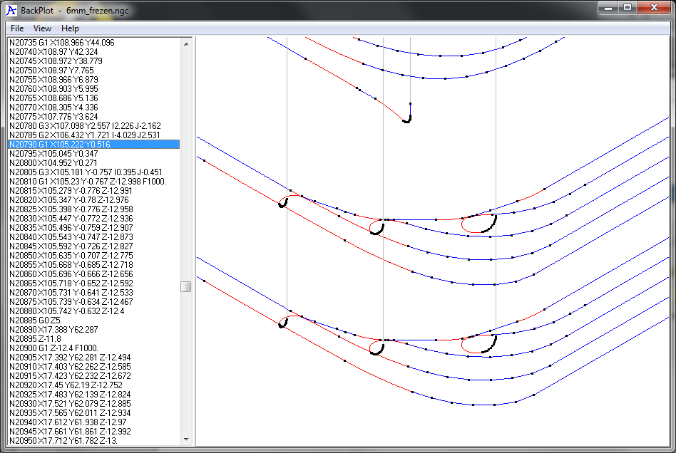

I am pretty sure it is not backlash. I am using double preloaded ballnuts on the screws and the screws are also supported with four angular contact bearings on each screw (two on each side, fixed-fixed setup). Checked tightness of the preloading screws, and theye were not loose. Besides: if it was backlash, I would see it as steps in the following error since the linear scale measurement is used as axis.N.motor-pos-fb.
Same with the servo loops: if the servo system goes crazy I would expect to see a ferror.
A remote possibility is that one of the scales is not measuring correctly and suffering from some 'stiction' or so. Although when that would be the case I would expect a more velocity-dependant result. Easy enough to take the scales out of the equation though (halcmd setp xscale_pid.max-output 0.0', done), so worth a try.
It seems to be a CAM-problem after all:
What exactly causes the problem is almost impossible to see in the backplot with those adaptive toolpaths. Backplot looks like a plate filled with spaghetti. I might want to open the file in an AXIS config so I can click on a G-code line and have it highlighted in the preview. Gmoccapy cannot do that yet.

I am trying to switch to Autodesk Fusion360 / Cam360 as my 3D CAD/CAM-system since as a noncommercial user I am allowed to use it for free and so far I seem to be able to do with it what I need. That beats, uhm, perpetual evaluation licenses of Solidworks and limited-feature software like DesignSpark Mechanical and FreeCAD for example
But I guess there is a learning curve involved; I should have used a contour finish milling pass for example but I was stupid enough to think the software did that for me. That Cam360 is in the middle between 'Tell me exactly what you want do do'-CamBam and 'Let me solve that for you'-SolidCAM. And probably there is a reason why it is still free for noncommerical use and quite inexpensive for commercial use...
