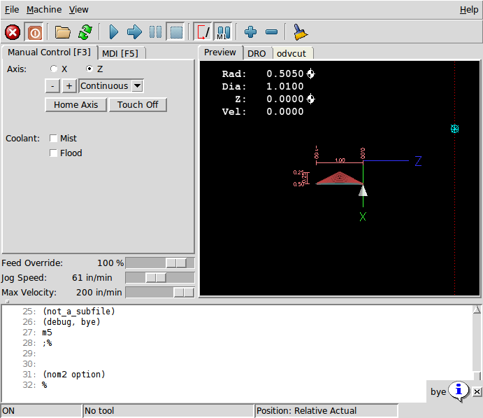

You could look at NGCGUI...
linuxcnc.org/docs/html/gui/ngcgui.html
www.linuxcnc.org/index.php/english/forum...broutines-and-ngcgui
The below code is not correct but a quick hack of an existing sub, but it gives you an idea.
(odvcut for lathe from odtaper3)
;Do not use, not a working sub
;concept only
o<odvcut>sub
#<Large_Diam> = #1 (=1.00 Large Diameter)
#<Small_Diam> = #2 (=0.500 Small Diameter)
#<Max_Cut> = #3 (=0.100 Max Depth of Cut)
#<Start_z> = #4 (=0.00 Z Start of Cut)
#<Center_z> = #5 (=-.500 Z Center of Cut)
#<End_z> = #6 (=-1.00 Z End of Cut)
#<Feed> = #7 (=4 Feed IPM)
; #<Final_Cut> = #7 (=.005 Final Cut)
; #<Fin_ Feed> = #8 (=2 Final cut speed)
; #<Spring_Cuts> = #9 (=0 Spring Cuts)
#<Stock_Diam_F> = #<Large_Diam>
#<Start_Diam_F> = #<Small_Diam>
;#<Large_Diam> = [#<Large_Diam> + #<Final_Cut>]
;#<Small_Diam> = [#<Small_Diam> + #<Final_Cut>]
#<Z_Len> = [0 - [#<End_z> - #<Start_z>]] ; length of Z cut
#<Cut_Amount> = [#<Large_Diam> - #<Small_Diam>] ; deepest X cut
#<Cuts> = FUP [[#<Cut_Amount> / #<Max_Cut>]] ; round up the number of passes to reach deepest cut
#<Max_Cut> = [#<Cut_Amount> / #<Cuts>] ; amount to take off X each pass
#<Z_Cut> = [#<Z_Len> / #<Cuts>] ;length of each Z cut
;(DEBUG, Stock_Diam #<Large_Diam>)
;(DEBUG, Target_Amount #<Target_Amount>)
;(DEBUG, Max_Target_Cut #<Max_Target_Cut>)
g18 (xz plane)
g20 (inches)
g40 (cancel cutter radius compensation)
g49 (cancel tool lengthoffset)
g90 (absolute distance mode)
g94 (units/min feedrate)
g54 (Coordinant system 1 default)
g7 (diameter mode)
g64 p.001 q.001
M3 ; spindle cw
G0 X[#<Large_Diam> + .010] Z#<Start_z>
F#<Feed>
G1 X#<Large_Diam>
#<Current-Diameter> = #<Large_Diam>
#<Current-Z> = #<Start_z>
#<X_Target> = #<Large_Diam>
#<Z_Target> = #<Start_z>
;#<Z_Target> = [#<Z_Target> - #<Z_Cut>]
o100 while [#<Cuts> gt 0]
#<Current-Diameter> = [#<Current-Diameter> - #<Max_Cut>]
;G0 X [#<Current-Diameter> + .010]
G1 X #<Current-Diameter> Z #<Center_z>
;G1 X #<Current-Diameter>
G1 X #<Large_Diam> Z #<End_z>
G0 X [#<Large_Diam> + .010]
G0 Z #<Start_z>
#<Cuts> = [#<Cuts> - 1]
o100 endwhile
; add finish cut here
M5 ; stop spindle
G0 Z #<Start_z>
o<odvcut>endsub
