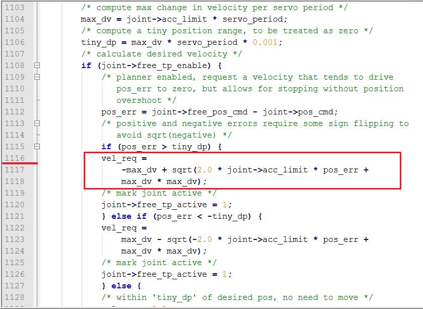

Replied by socrassi on topic get_pos_cmds()
Now,i can conclude that the value of vel_req is the root of the quadratic equation.
which is : vel_req^2+ 2*max_dv*vel_req - 2*(joint->acc_limit)*pos_err =0
But i don‘t konw how can we get the equation?

18 Mar 2015 21:39 #56986
Replied by andypugh on topic get_pos_cmds()
I don't think anyone here wrote that code.
You would have to try this question on the developers mailing list.
Do you have some reason to believe that the equation is wrong?
Bear in mind that there has been a recent upgrade to the trajectory planner, that code might not even be used any more in 2.7 +
