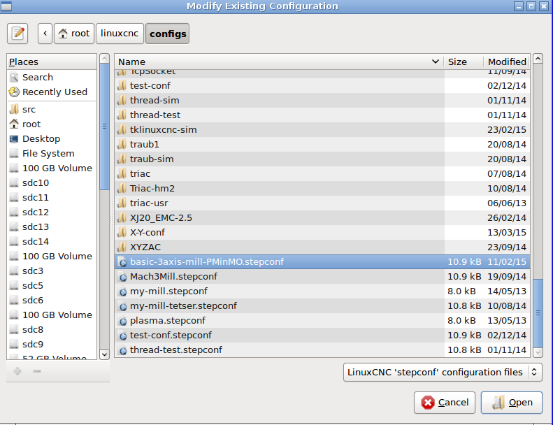

I created a configuration using stepconf. Later, I tried to edit the configuration, again using stepconf.
I get the initial screen where you choose between a new configuration and modify an existing one. I pick modify.
I now can navigate to my existing configuration file and select it. When I push "open", the window with the available files blanks and nothing else happens.
I can go through the selection process again, pick the config file, push "open" and nothing happens.

I can't replicate this, but we have no idea what version of Linuxcnc, what distro etc you are using
It won't be anything to do with permissions.
Even if the file permissions were just 444, you would still be able to open it for reading, which is all you are doing at that stage.
Open a terminal and run stepconf from the commandline.
Do you get any error output when this happens? If so capture it and post it.

Thank you ArcEye for getting me to look at the problem from a different angle. It turns out to be simple, as it had to be.
When I tell stepconf to open an existing config, it lists everything in my linuxcnc/configs directory, not just the *.stepconf files. I was selecting the myname directory, not the myname.config file. Obvious now, but I didn't even consider that the search would not be selective.

The search is selective and only shows *.stepconf.
If it did not show directories, it would never be able to navigate to somewhere else, if for instance a user had moved all their stepconf files into another folder,
perhaps even the config folder for that particular machine.
