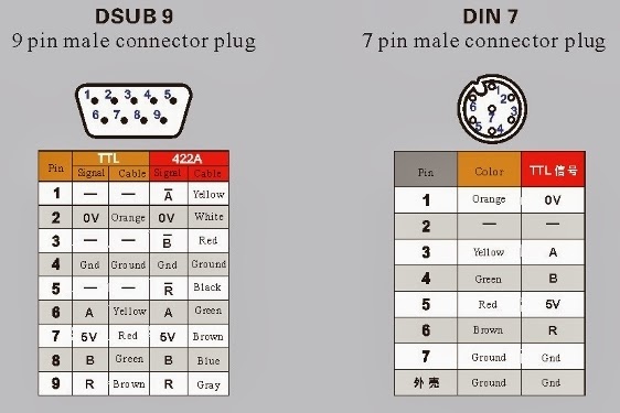

I am trying to decide whether to use steppers or servo's on my mill when I put ball screws on later this year, so I would like to know if linuxcnc can use the signals from the easson dro as position feedback? It would seem a shame to have very accurate position information there and not use it.

The important thing to know about your Easson scales is that they are glass scales outputting a 5 volt TTL Quadrature signal
With that knowledge, there is a post of quite recently that should help you

06 Jul 2015 17:27 - 06 Jul 2015 17:31 #60465 by cncbasher
Replied by cncbasher on topic can linuxcnc use easson dro for feedback?
yes you can they ( scales ) output quadrature , see attached pic , but beware i have known different pinouts
these are at least the common pinouts used
you may find other information that may be helpful here
www.yuriystoys.com/p/msp430-launchpad-quadrature-dro.html
