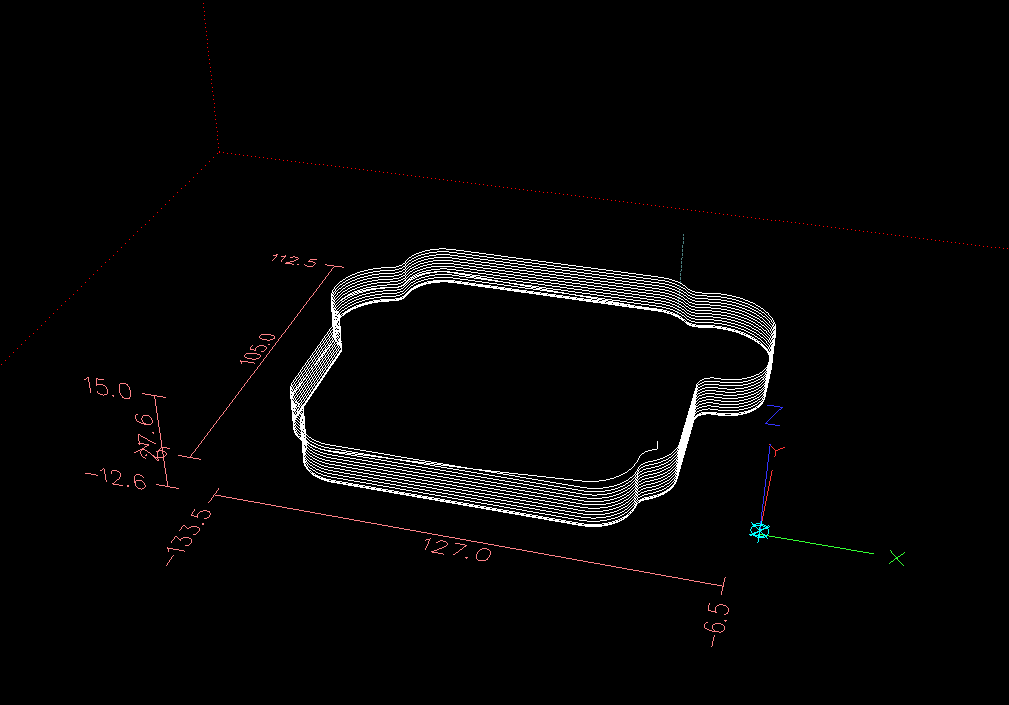

I am using fusion360. I have done a lot of machining without any post process type issues. Plenty of other issues with the CAD program lol but not with code. Until now.
I was machining this part with a bullnose cutter doing a 3D pocket. I also did the outside profile to see how it did with the bullnose but it was struggling so I went into CAM and selected a 7mm flat mill that I have used before.
I post processed the toolpath and went back to my machine and it said that the new program exceeded my y travel. I came back in and looked everything over, ran a simulation and posted it again. This time I could see the toolpath in the viewer starting maybe 100mm or so further -y than it should have. Sometimes when I open it in linuxcnc it seems to show that line, other times it doesn't.
I restarted and rehomed linuxcnc and it still did it. Restarted the CNC computer and then linuxcnc and it still did it. Restarted fusion360 and it still did it.
I have scanned through the code and I don't see anything that suggests that it should start where it is.
So first question is does anyone have any ideas or input?
Second question is whether anyone else is seeing the same issue on their linuxcnc?
The issue is right at the beginning of the code.

N65-70 drops down outside the machines travel and then N75 is a long line on the visual display going from 100mm away from the part over to the part.

04 Nov 2015 00:24 #64713 by yoshimitsuspeed
Replied by yoshimitsuspeed on topic Possible bug or other issue
Thanks for all the help guys.
First I'll report on the problem then try to answer a couple of the other questions.
It was in fact an offset in the tooltable. It is strange because over a period of time I had added tools into it manually with more information in the tooltable but when I opened it today there was only one tool that had the tool info like I had added manually for many others in the past. Then tool 13 had a 154mm offset on y or something with no other information. Had I manually added it then it would have had more information in the comments section but it just had a date like all the rest.
I am a little confused though because if it was a y offset then wouldn't the whole toolpath have been moved in that direction as opposed to just the starting point of the z drop?
Attached is a pic of the toolpath in my system.
A couple other things. I removed the offest in the toolpath, opened another toolpath, acknowledged the tool switch then opened the problem file again and it still showed this messed up toolpath. So I closed linuxcnc, ran system updates, re opened linuxcnc and then opened this file and it showed up fine and started a dry run and everything looked normal. For troubleshooting purposes I probably should have tried restarting linuxcnc without updating so I don't know if the update had any effect. Something about the linuxcnc toolpath something or another was updated.
So whatever the case it does appear to be fixed. It does seem like it must have been related to the offset in tool 13. I just can't figure out what happened to my manually entered tools or how, why or when that offset would have gotten there.
I wouldn't have suspected that because as said above I would have expected it to move the whole toolpath. Is that not correct?
04 Nov 2015 00:35 - 04 Nov 2015 00:36 #64715 by andypugh
Replied by andypugh on topic Possible bug or other issue
No, the machine bounding box will move, but the toolpath stays in the same place.
You can try this by using the touch-off button in the Axis GUI. Touch-of Y to 150 After selecting T for tool table in the drop-down and the tool will move, the bounding box will move, but the tool path will stay in the same place, because the actal XYZ numbers stay the same. You then need to re-edit and re-load the tool table, though.
After editing the tool table you have to explicitly re-load the tool table (option in the File menu).
