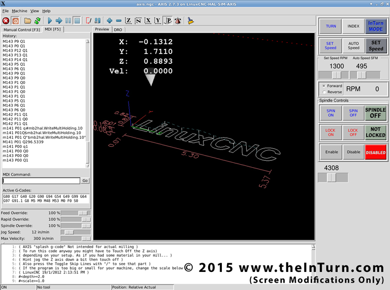

01 Jan 2016 10:06 #67651 by Simpson36
Here is the screen so far. All of the buttons/sliders, etc on the right side PyVCP panel are hooked up and working fine. A lot of data has to go thru conversions and/or other work arounds but this part was pretty easy once I got my brain around how the various pieces fit together ('net' function, ini files and so on.).
I have another thread going about fixing some things in the mb2hal and the C header file has been located and there are instructions from 'Big John' on downloading some development tools. I am familiar with C and compilers (to a degree) , but at this point I have no idea how to go about compiling code for Linux/LinuxCNC or how to contribute and navigate the git stuff.
I am more than happy to help out, but I'll need a project lead (or equiv) to give me specific tasks to do . . . and probably how to do them . . . :blush:
