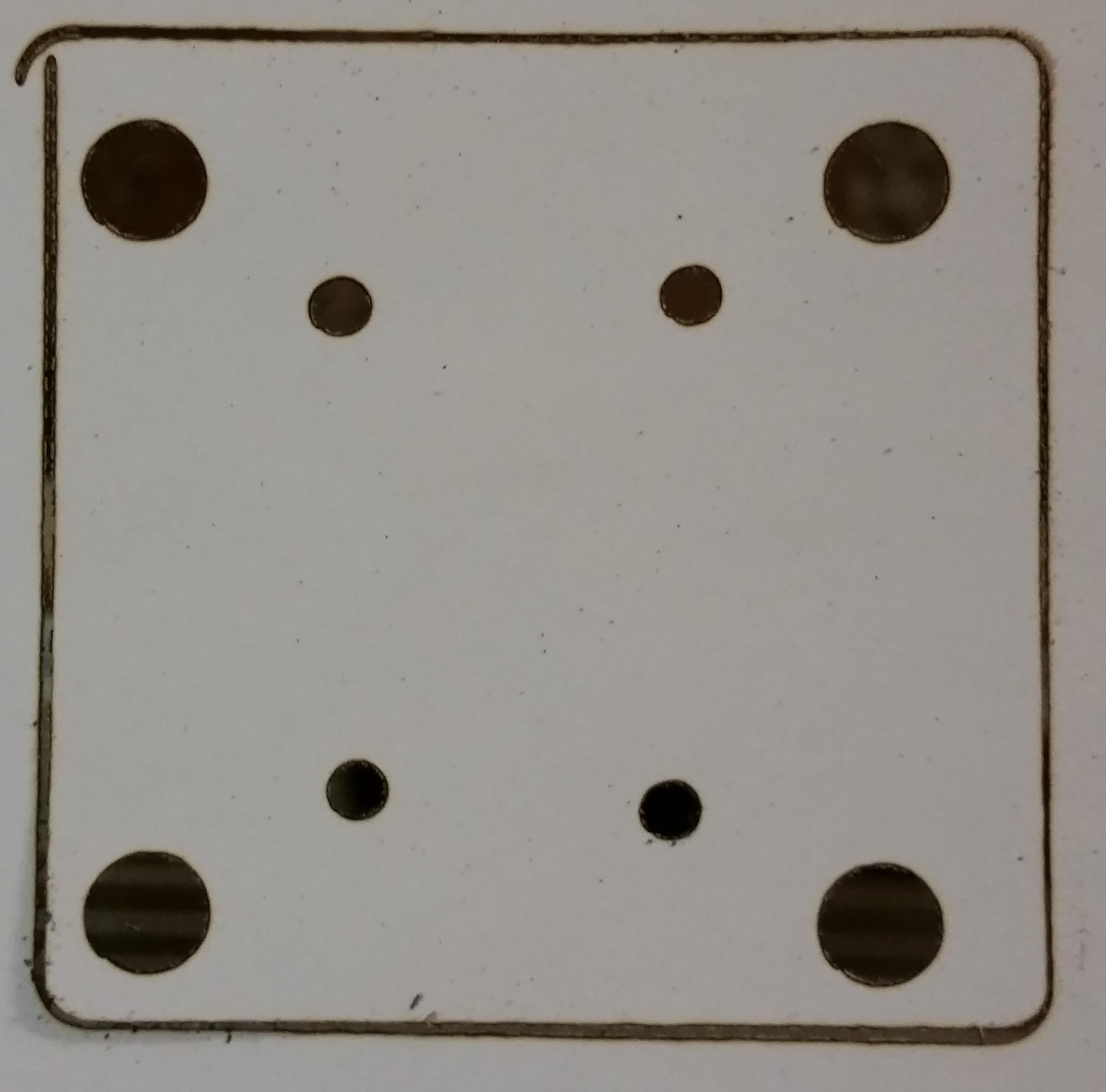

Hi everyone,
I'm putting together a laser cutter, and I'm almost there, but I've run into an interesting phenomenon that I can't identify: my GCode test program starts and finishes cuts in different locations! The finishing location is consistent every time, about 0.05 inches to the right (+x) and 0.05 inches up (+Y).
At first, I thought my issue was backlash, but my diagnosis doesn't seem to prove it. Here's what I've done.
If I re-run the program, the location for HOME has been lost, and new cuts start off set by about 0.05 inches to the right and about 0.05 inches up--just like the finishing location. Re-running the program over and over will continue to move the home location slightly up and slightly to the right by a consistent amount.
I thought this issue might be lost steps, so I slowed down the cutting speed from 1500mm/sec to 300mm/sec. Oddly enough, the slower it gets, the worse the offset becomes (as if the sheer amount of time spent cutting makes the problem worse the longer it goes).
As a heads-up, this is a new issue. Cuts used to start and finish in the same place without issue.
I'd love your thoughts on this one. Thanks!
Here's an example of the offset at 300mm/sec:

Sounds like missing steps.
Besides checking for mechanical problems such as binding try dramatically reducing you acceleration settings in your configuration file.

Yup! That was it! Missing steps....
Speedwise, things were OK. It turned out to be my motor controllers from GeckoDrive
Two minor tweaks fixed the problem:
After that, everything looks good again, and I can kick out paper cuts at a respectable 1500mm/min.

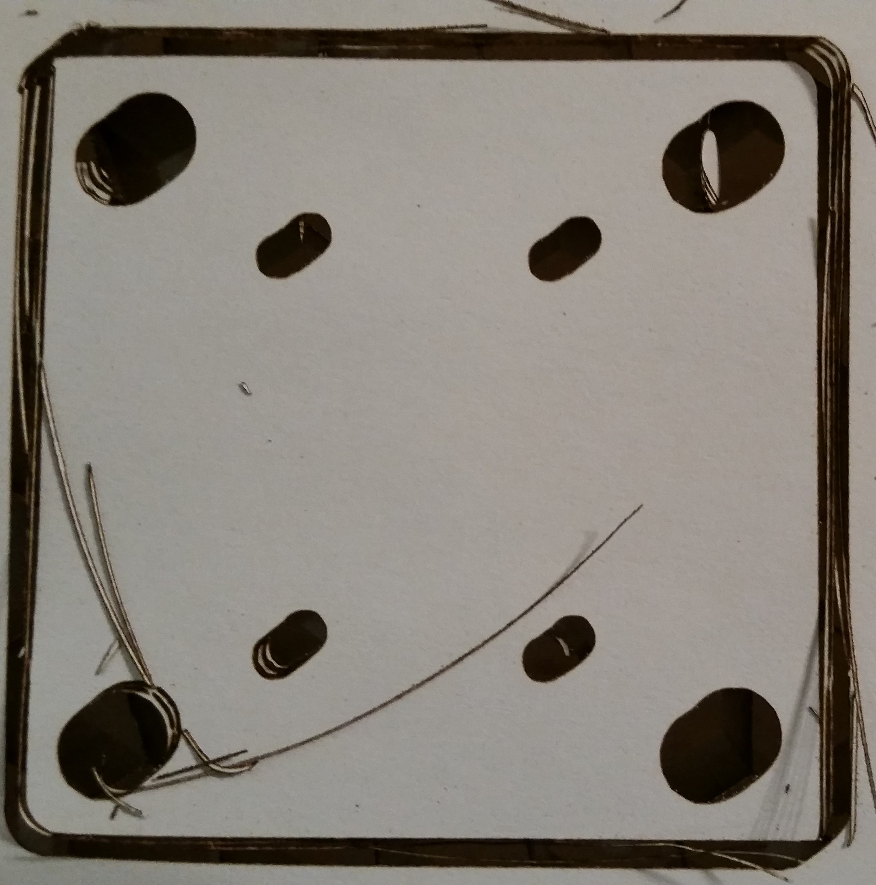

I'm adding another image back when I was skipping steps--just in case anyone else in the future needs to diagnose a problems like this. Here's a repeated run over five iterations:
- bumped up the maximum current sent to the y-axis motor
- tuned the trimpot such that the gantry would move with the minimum possible vibration at low speeds

I'm adding another image back when I was skipping steps--just in case anyone else in the future needs to diagnose a problem like this. Here's a repeated run over five iterations:

To revisit an old topic..
Yes, tuning the motor controllers did help, but the actual cause of the problem now appears to be electrical interference of the laser tube power supply acting on the motor controllers.
Switching from a motor controller with an exposed PCB to a motor controller enclosed in a metal housing has finally fixed the issue. I suspect, though, that putting the original motor controllers in a metal box may would've also done the same thing.
Cheers!
Cheers!
