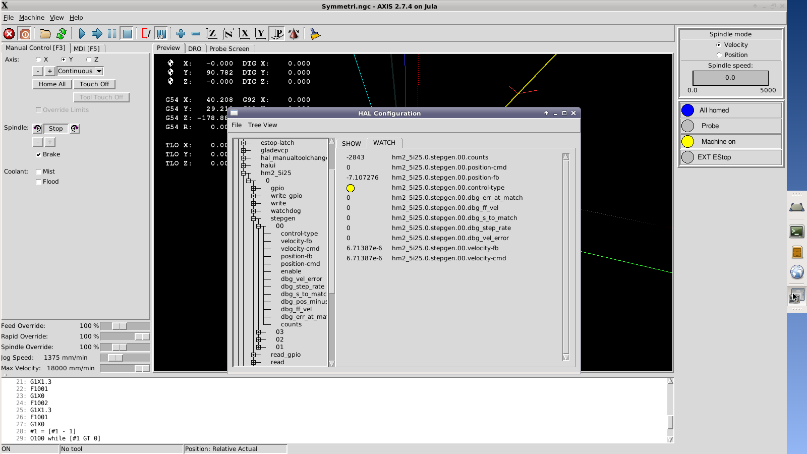

Open the Show Hal Configuration (assuming Axis) and locate the X axis step information and add that to a watch window. Run your program with your pointer on the shaft. If the numbers are the same for step count at the end then you have a mechanical/electrical issue. What voltage are you running the G213V?

Voltage feeding the stepper drivers is 35V unregulated.
The step counts in the Watch window does not show the error, it returns to the same value for X0 after any number of cycles.
Why is "position-fb" not zero when the motor is stationary at X0?
I made a very wrong assumption that the error only affects X. It is present on Y and Z also with the same magnitude. For some reason I did not notice, but I have checked now. Especially, the Z axis drifts upwards against gravity 0.01 mm for each program iteration.
