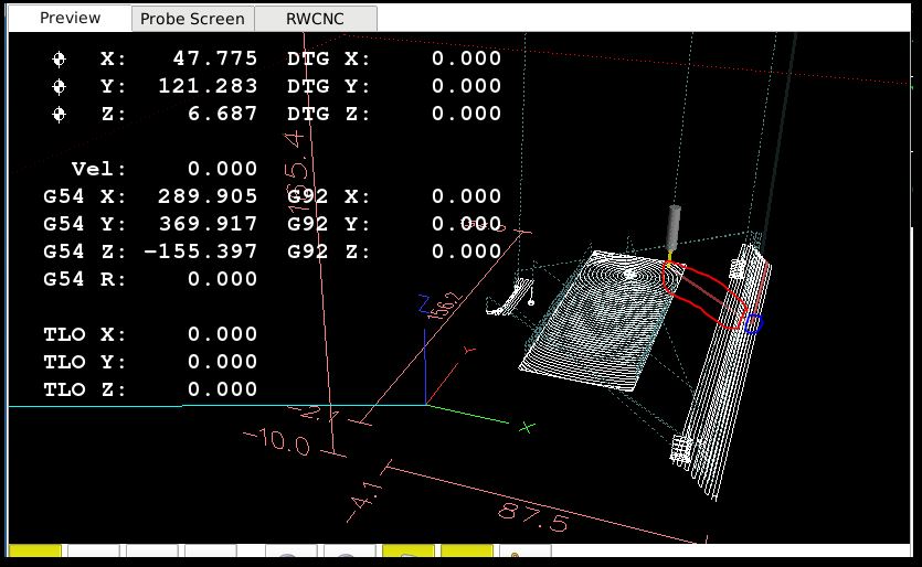

Gents
After the upgrade to 2.76 (I am also running gmoccapy) I noticed that when I press the stop on the screen, the tool keeps on moving. Cost me a cutter just now.
Sorry for the bad photo. It was cutting the hole, when I pressed the stop button, but kept on moving, on its own.
Any Ideas please?
Ruben

Hi Todd
Thanks for the reply. I have upgraded fro 7 to 7.5 and then to 7.6. Gmoccapy is still the same version. The UI is fine, I don't have any issue.
The stop button worked 100% before. The problem now is when I press it, it moves in it's own direction, not in the path via GCode. And yes, I press it on the screen. I have always, and I don't want to press the EStop. I tested the Pause button and that works fine.
If you look at the attached screenshot, I pressed the button on the blue circle. It moved all the red, before I hit the estop.
Hope that make a bit more sense.
Ruben

Start that config without the probe part and see if it does that. Just a wild guess but could be it.
