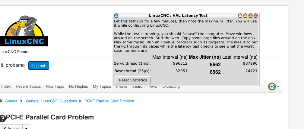

I have read everything you posted, and looked in wiki, and on youtube how to set hal file for PCIe parport card. More-less took advance lessons, rather than basic course

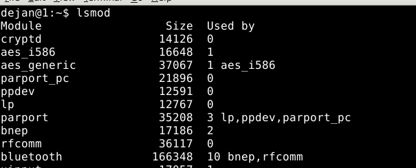

,Found celeron with very good latency (see file latency) attracted my attention, but w/o parport card on the motherboard. There is only PCIe slot available. The card is WCH (CD with drivers comes as a package) with 2S1P (2 serials 1 parallel). According to instruction I installed driver (make, make install) and reboot system. Enclosed file 2 showing there is lp,parport, ..., but in lspci -v there is no single identification of any card that kind, or I miss something?Thank you,

Looking at the output for lsmod by the poster lp,ppdev,parport_pc,parport are loaded.
If all is well there should be an entry here /proc/sys/dev/parport/ for parport0 (if the PCIe card is the only card) there also should be an entry under /dev/ for parport0
