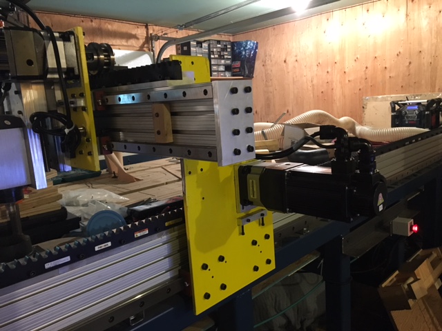

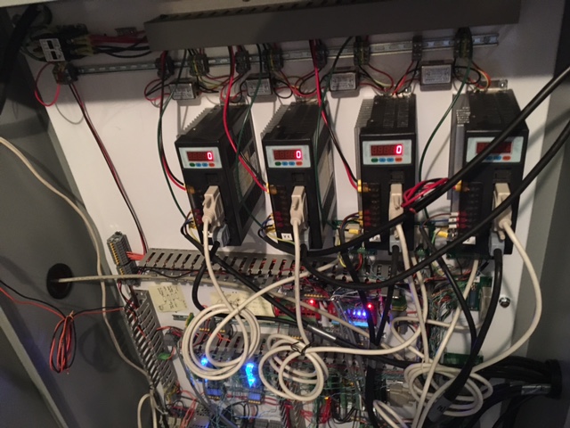

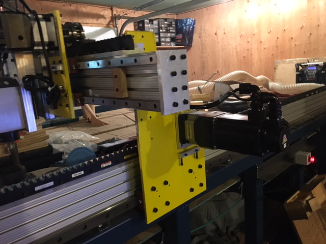

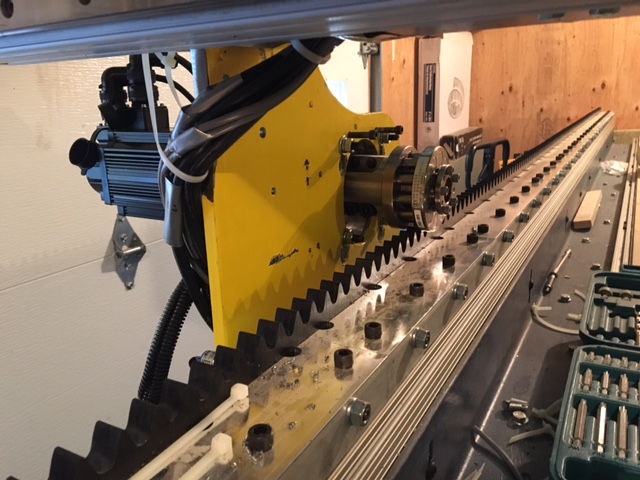

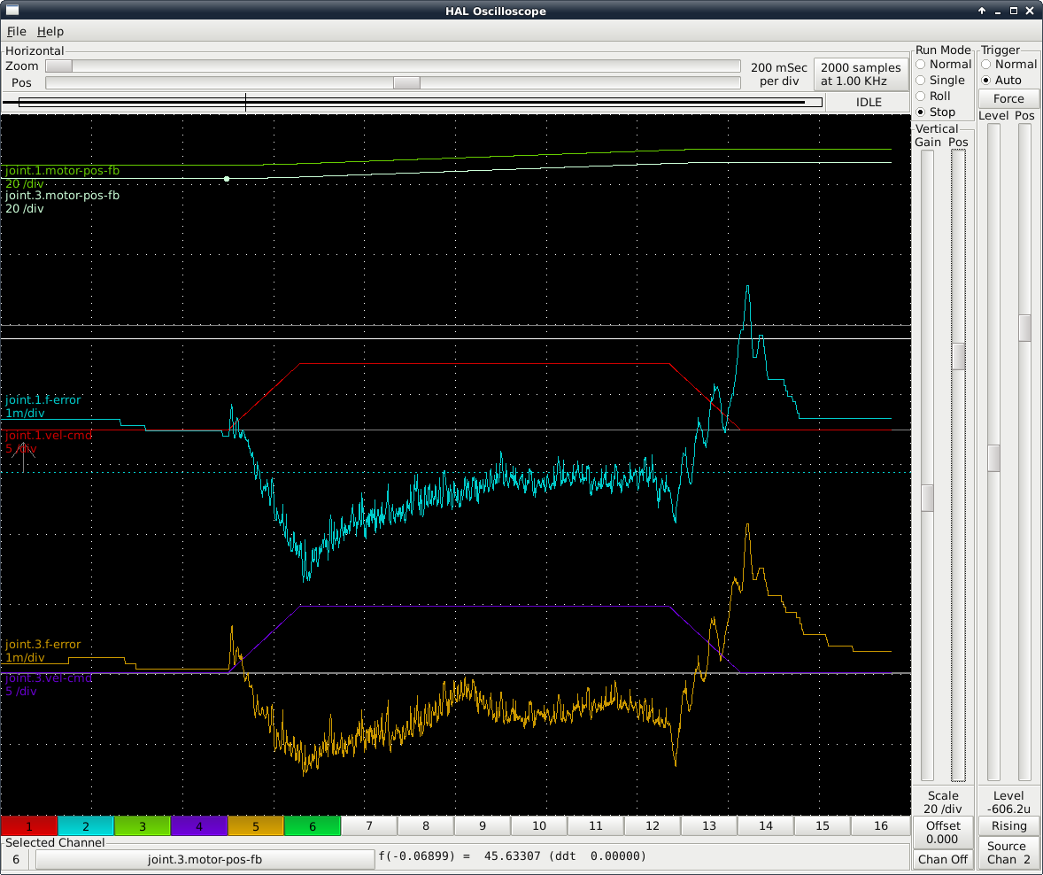

JA in 2.8 has fixed my issues I was having. Everything is working as expected except I cannot get servos tuned on Y.
Y is the axis that has two motors. I have these drives that has a closed loop within. There are options to open them up so that you can close the loop with Linuxcnc and I did. From what I understood from the manual was when you do that it doesnt use the pid or the adjustments within the drive that the PID is being controlled outside the drive. This doesnt seem to be the case. The parameters within the drive still effect the drive/motor and so does the parameters in Linuxcnc. So I am having a hard time getting them tuned so they stay synced. Problem is if they are not then when I turn on the machine it racks the gantry hard.
I am trying to get it close so when I engage the motors and turn on Liniuxcnc, it doesnt rack.
I attached some pics so you can see the motor drivetrain. Also some halscope images. This is the closest I can get.
The halscope shows the two joints on Y, F-error, vel-command and motor-fb
Note: the f-error is on 1m/div

04 Nov 2016 13:47 #82419
Replied by Todd Zuercher on topic Once again two servo's on one axis issues
What were your pid settings for the above trace? Specifically the FF1 and 2?
Looks like those need some fine tuning.

04 Nov 2016 14:40 #82424
by bevins
Replied by bevins on topic Once again two servo's on one axis issues
FF1 to get the ferror fixed and FF2 for the acel and decel?
I am not in front of it now but will post them later.

04 Nov 2016 19:36 #82447
Replied by andypugh on topic Once again two servo's on one axis issues
The actual magnitude of the f-error seems quite small in absolute terms?
Is it a mm or inches machine?

04 Nov 2016 21:02 - 04 Nov 2016 21:05 #82451
by bevins
The machine is in inches.
The pids for the two Y joints are as follows:
Y1
P = 20
I = 0
D = .5
FF1 = .257
FF2 = .00125
BIAS = .099
DEADBAND = 0
Y2
P = 20
I = .1
D = .5
FF1 = .257
FF2 = .00115
BIAS = .099
DEADBAND = 0

04 Nov 2016 21:10 #82455
by bevins
I cant seem to get the and decell spikes down. Those are the opnes causing the issues I think.
FF2 is not changing it. I am thinking it is in the drive somewhere.
