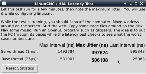

Hi. Right now not I am NOT a happy camper with Linux/CNC ,been doing a-lot of reading and Youtube looking but more I get lost with the Max Jitter setting so CNC will start up .How do I fix/reset the setting for it to run right ???
Laptop Dell D620 1.6GHZ, 4GB memory HD 60GB
OS LinuxCNC 2.7 from live CD updated to 2.8 -- screen saver off and power saving off , no battery, running on AC - so its real time running
Thank You.

- Posts: 19899
17 Nov 2016 15:23 #82902
Your problem is nothing to do with max jitter at all.
The problem is that LinuxCNC can't find your parallel port.
However, your max jitter values do seem rather too high to be useful as things stand.
Replied by andypugh on topic Max Jitter input for NewBeee
Error: could not insert module /usr/realtime-3.4-9-rtai-686-pae/modules/linuxcnc/hal_parport.ko: No such device

Thank You for the info . Question I have no parallel port on the Laptop D620 Dell so am I Shit out of luck to use this Dell to control a CNC Router with USB Arduino UNO Org and TB6600 driver for the stepper motor ?
- Posts: 19899
17 Nov 2016 18:46 #82913
Sadly, yes. LinuxCNC does not support _any_ USB interfaces for machine control.
Your only option with that PC would be the 7i76E
It is probably more cost-effective to buy a different PC with a parallel port, but the 7i76E does offer much faster step-generation than the parallel port, spindle control and a lot more IO.
