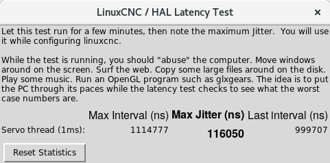

Hello Forum
After getting disappointing latency test results from the Jessie uspace buildbot package, I built linuxcnc-2.7.8.7.g8a172f6.1 by the 'apt-get source linuxcnc' method.
I see the same high latencies with my locally built package, and question if latency-test is running with realtime priority. (see attachment).
What scheduling policy and priority should latency-test have, and how is this priority established?
