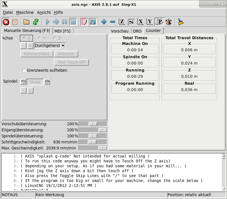

12 Mar 2021 12:25 - 12 Mar 2021 12:53 #201953
by HansU
Replied by HansU on topic Accumulated travel distance for axes
I added the functionality in Norberts timer-VCP (Glade). See: forum.linuxcnc.org/gmoccapy/40709-gmocap...lock?start=30#201950
I think it's easier to set up than the solution with paramsaver.
You can also include this VCP in other GUIs than gmoccapy.
In AXIS you can integrate it with following entry in the INI-file
Then it would look like this
[DISPLAY]
EMBED_TAB_NAME = Counter
EMBED_TAB_COMMAND = gladevcp -x {XID} -u counter.py -H counter.hal counter.gladeThen it would look like this
Last edit: 12 Mar 2021 12:53 by HansU.

- itsme
- Posts: 78
- Thank you received: 21
12 Mar 2021 13:31 #201962
by itsme
Replied by itsme on topic Accumulated travel distance for axes
Are the values saved or will they be reset after Power cycling?
- HansU
- Posts: 723
- Thank you received: 217
13 Mar 2021 08:58 #202074
by HansU
They are all saved in a *.var file except the value "Program Running Time".
The following user(s) said Thank You: itsme
