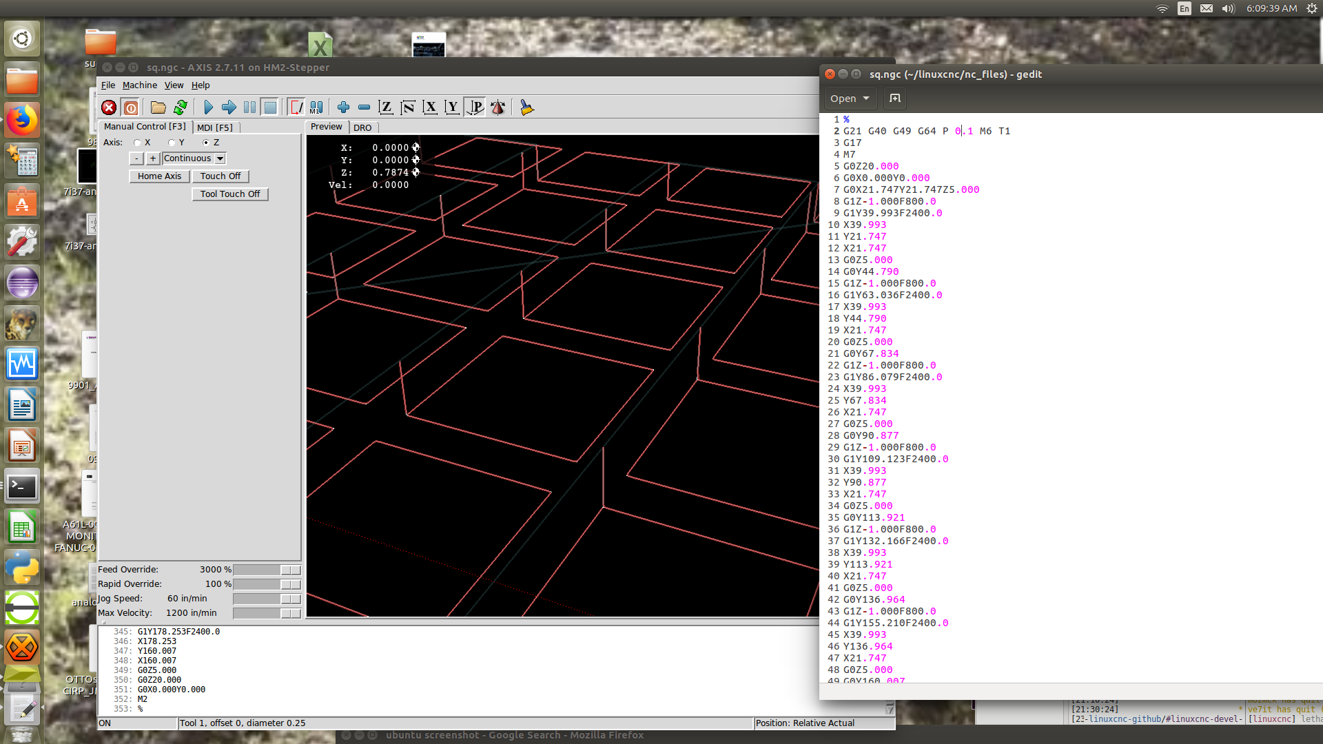

26 Dec 2017 13:25 - 26 Dec 2017 14:21 #103646
Replied by PCW on topic BUG: G64 P0.1 not respected when in the same line with other g-codes
Test setup is 1200 IPM ~1/2G I suspect this is faster than most
I can see the G64 tolerance dependent deviation from the gcode in the backplot
so it's apparent that the G64 P setting is being read,
so the question is: why doesn't this work for you?
Do you have a simple gcode file that exhibits this problem?
Can you post your hal/ini files?

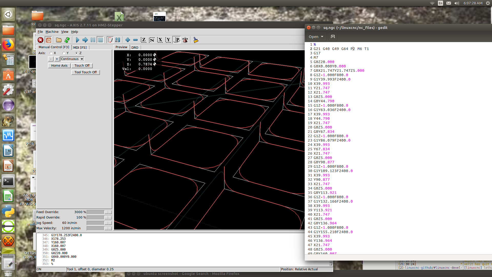

27 Dec 2017 08:02 #103736
by cptX
Replied by cptX on topic BUG: G64 P0.1 not respected when in the same line with other g-codes
Hi PCW, attached you can find a test file.
- Posts: 18111
- Thank you received: 5330
27 Dec 2017 14:22 - 27 Dec 2017 14:52 #103748
Last edit: 27 Dec 2017 14:52 by PCW.
