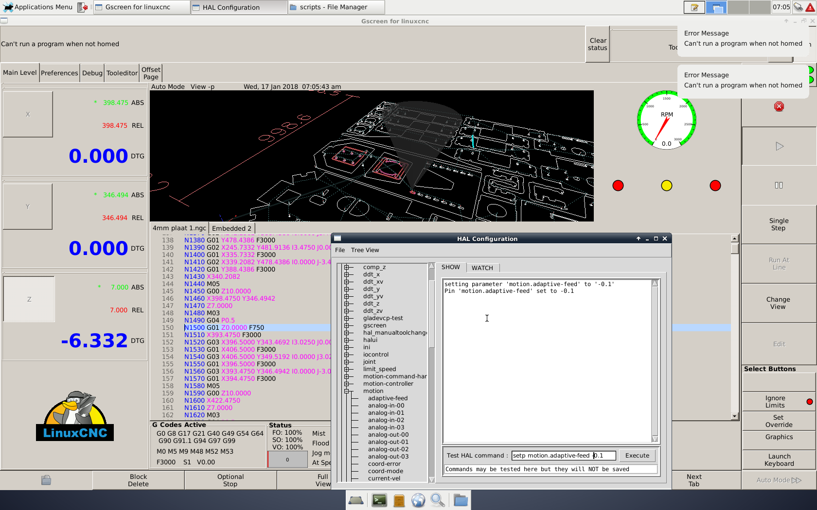

I just have succesfully did a git clone of github.com/LinuxCNC/linuxcnc.git
installation complete. Did it 2 times to practice. Problem yesterday was i needed to install the needed build packages.
Now i don't know how to clone the reverse run version : github.com/LinuxCNC/linuxcnc/tree/feature/reverse-run-master2
If i select clone on the git site, i always get the same adres : github.com/LinuxCNC/linuxcnc.git
How to get the reserve run version?
Merging by 25 files by hand, i will try, see picture. Maybe it's gonna work.
I expect a adres like : github.com/LinuxCNC/reverse version... git
I have also made a comment on git : github.com/LinuxCNC/linuxcnc/pull/397

Replied by rodw on topic Linuxcnc motion backwards (adaptive-feed negative value) and nothing happens
A different branch but here is what Dewey gave me
where the_src_dir usually will be linuxcnc_dev
This will replace your version of master with the branch. You can follow the same instructions to go back to master.
There is a way to merge and rebase branches but you can get into trouble quickly. I did it once and then had to delete everything and start again. Google "Git merge" and "git rebase" and see what you find. There should be a source editor that allows you to view 2 files side by side and accept or reject changes. Maybe someone can chip in. I suspect that it would be best to do the edits by hand rather than just blindly adopt it but someone more experienced might chip in.
1) if building from source:
a) $ git fetch
b) $ git reset --hard origin/dgarr/external_offsets
c) $ cd the_src_dir; make && sudo make setuidwhere the_src_dir usually will be linuxcnc_dev

17 Jan 2018 11:19 - 17 Jan 2018 11:26 #104616
by Grotius
Replied by Grotius on topic Linuxcnc motion backwards (adaptive-feed negative value) and nothing happens
@Rodw,
I merged by hand 25 files, one file had 180 correction's.
i did the compare by hand with the current master branche.
It's working now. Was not easy. But in the end it's working.
Also with compiling i had to solve several incomplete statement's. But all i think solved without damaging the code.
I have made a short video with my old mobile phone

17 Jan 2018 12:10 #104618
by Grotius
Replied by Grotius on topic function motion backwards adaptive feed is working
Hi Rodw,
I tested also gscreen. This is also good working with negative speed commands.
I will put it later on the git. i have already a account over there.

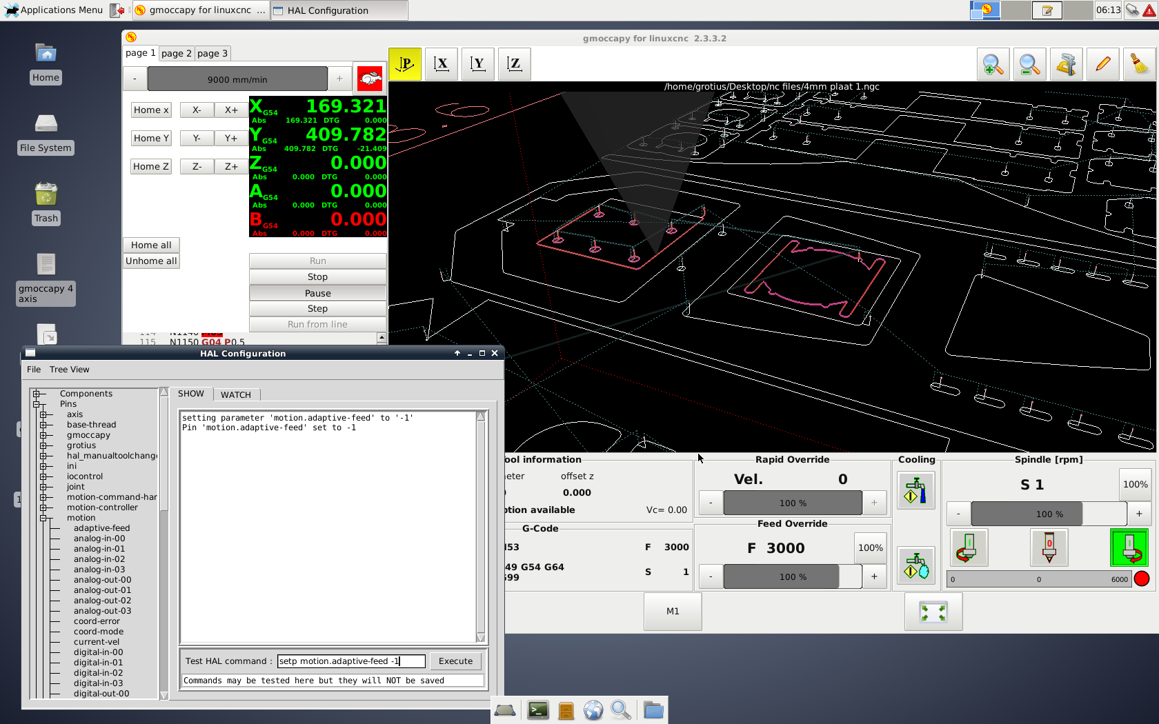

22 Jan 2018 16:46 - 22 Jan 2018 19:08 #104852
by Grotius
Hi Rudydp,
I am using the latest version of linuxcnc, you can find this with the synaptic package manager in your system file menu.
Search for example on the buildbot channel.
I have crossed this latest linuxcnc version with the reverse master 2. Here is the url for the reverse branche :
github.com/LinuxCNC/linuxcnc/tree/feature/reverse-run-master2 reverse run master on git
To compbine this 2 files was a very risky job, because you have to do 25 files. One file had 180 lines to be changed. So one digit mistake can mesh things up. But i had the time, and after all it works great !! It's a great function for plasma and tube cutter with 3 or more axis that have to go back to restart. So very important function for the future. Also for 6 axis robot's it's a very beautiful
function. You can go back with a reverse interpolation on 6 or more axis. That's wat it looks like.
Rudydp, you must compile my version of linux yourself, i have a little tekst document how to do that. Important is that you follow all the steps, because if you new with this, it can be very difficult.
I will look to place it on the git. Else i can make a download link for you.
For info : I have compiled the new adaptive feed version again yesterday. It compiles good. Also i compiled the latest linuxcnc version. They compile the same, so it's good.

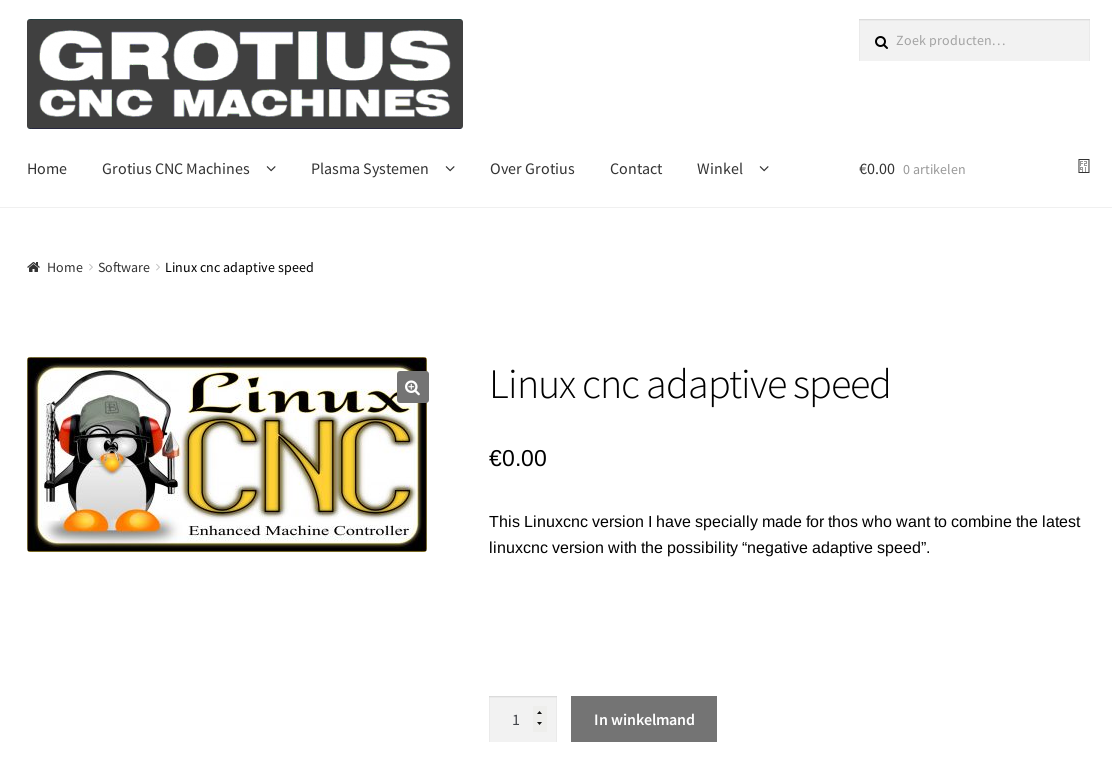

Okey i made a download link and added a nice picture from the forum, nice high reselution pic anyway,
if you look good, you see the bitcoin's logo in the head cover of the pinguin :
download link Linuc CNC negative speed non compiled version
You only have to registrate, after that you get the download link by mail.
We donate your 1 euro to : www.brainlab.com/en/

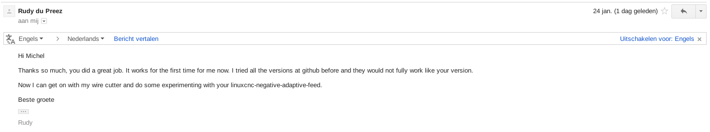

22 Jan 2018 20:02 #104865
by rudydp
Replied by rudydp on topic function motion backwards adaptive feed is working
I have the 2.8 reverse-run-master2 branch downloaded with git and have build it and it does give me adaptive feed after using M52 P1, but I do not get negative feed ie. 0 to -1, to work. Is there some other command required to get reverse feed?
I have also tried to register for your compiled version download, but have not made a payment (not easy without credit card), so I dont know whether I will receive the download link by e-mail.

Rudy has downloaded the motion backwards from my website and installed it. On the 24 januari i get this mail :
I have already a github account but don't know how to upload the files over there. Someone can help?
So for clearity : this is the latest linux version combined with feature reverse run master, maybe we can put it in the master
branche.
Download link : www.grotius-cnc-machines.nl/product/linux-cnc-adaptive-speed/
branche.
