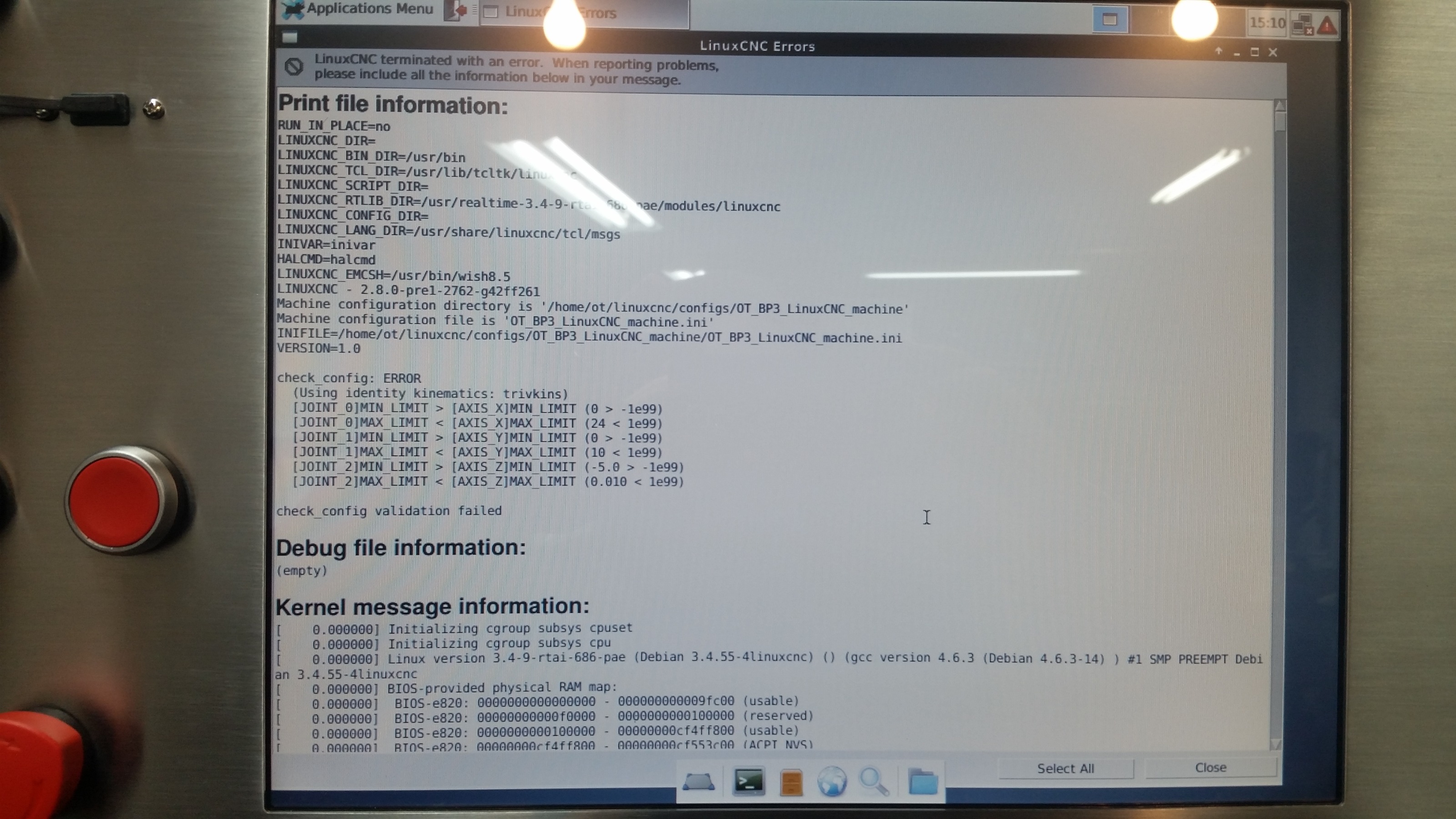

I'm trying to copy and past a working config within the configs folder, renaming it and editing to work on a new configuration. I have done this many times before on an other machine but for some reason this time it errors out. The ini file has been edited to reflect the correct file names to load. It errors out on the copied and renamed version of a working config. The copy is identical just re-named. What am I doing wrong or what's is missing?? Original file was generated with pncconfigurator.
I'm using debian, axis2.8.0-pre1-2762-g42ff261. Sorry, only got a screenshot jpg of the error message.

I have seen that error before myself. I can't remember how I resolved it. V 2.8 brings with it joint axis code so joints are separated from the axes. I would look for inconsistencies in your ini file configuration of the joints vs the axes min and max limits etc. Thats actually what the messages are telling you. If you can't see anything, then upgrade to the latest version of master as it may have been my problem was fixed by a bug fix.

It would be easier for folks to help if you post the ini file.
The error messages say:
In the master branch, distinctions between joints and axes
are stricter than in earlier branches. 'Joints' (0,1,...)
are typically motors or other actuators, 'Axes' are the
coordinates (letters) in cartesian space handled by gcode
(XYZABCUVW).
For trivial kinematics, an identity relation is expected
between joint numbers and axis letters so the LinuxCNC
startup script invokes 'check_config' to verify that the min
and max limits for each axis letter are within the bounds
set by the corresponding joint limits as noted in the error
message.
If an ini file using trivkins omits specifications for axis
letter min,max limits, the values used are -1e99 and 1e99
respectively.
Hence, your ini file has lines like:
but likely omits the corresponding lines that specify axis
limits that are within the joint bounds, like:
This check ensures that trivkins machines do not specify
axis limits that exceed the corresponding joint limits.
Ref:
github.com/LinuxCNC/linuxcnc/blob/0a096c...c/ini/iniaxis.cc#L79
github.com/LinuxCNC/linuxcnc/blob/0a096c...c/ini/iniaxis.cc#L90
check_config: ERROR
(Using identity kinematics: trivkins)
[JOINT_0]MIN_LIMIT > [AXIS_X]MIN_LIMIT (0 > -1e99)
[JOINT_0]MAX_LIMIT < [AXIS_X]MAX_LIMIT (24 < 1e99)

You guys are correct of course
The ini and hal got scrambled. What I can't figure out is how?? If I copied a bad config (labeled copy of the original) or if the original changed automatically during the copy/past process. I tried to repeat the copy error which didn't occur if I created a new directory on the desktop, copied and renamed the config files then pasted them back into the linuxcnc configs folder. Everything stayed operational. If I copy paste the files directly within the configs folder I was getting inconsistent results. Is that even possible? Can someone try that on their machine to see if their copied ini file changes??
