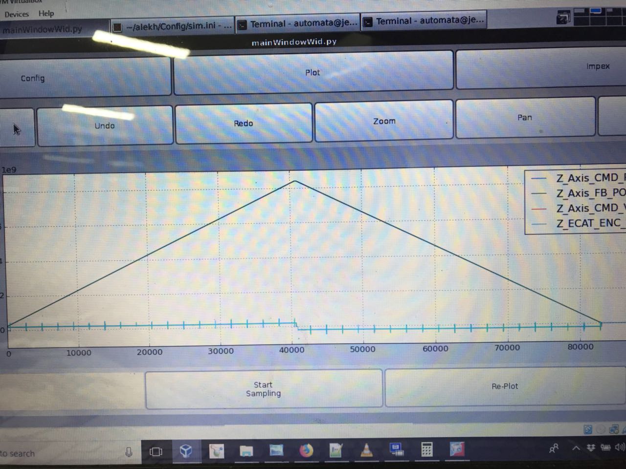

I am using Ethercat hal driver with lcec & lcec_conf...i am facing synch & DC(distributed clock ) issue...i am using panasonic A6 drives & motor...i am running lcec in csp mode...
i have attached ecat_conf.xml file for ref. and output waveform of pos-cmd(motor-pos-cmd), pos-fb(lcec.0.0.pos-fb), internal cmd velocity and velocity- feedback(lcec.0.0.actvel) ethercat bus. you can see in the waveform that on feedback velocity graphs there is spikes at certain fixed interval (approx 2.3 sec).
anyone have any idea about this??
it would be great if anyone can help me with this.

8 years 7 months ago #107415 by sirop
Replied by sirop on topic EtherCat Sync & DC problem
Hi.
Why do you suspect it to be Sync & DC problem?
If you run your slaves in csp (Cyclic Synchronous Position),
you send increments of position and - I guess - wait until the target position is reached.
The each time your velocity would increase up to a certain value and then decrease.
Check the manual of your drive for Trapezoidal and S-curve Motion Profiles.

8 years 7 months ago #107460 by Automata27
Replied by Automata27 on topic EtherCat Sync & DC problem
Hi sirop,
thanks for reply...
i have checked in servo drive's s-curve profile parameter and have tried setting position command smoothening parameter also...in this case amplitude of spike gets reduced but still that spike comes at regular interval...setting this parameter will increase ferror...secondly i am not using motion profiles from drive, i am using linuxcnc motion profiler...
i am suspecting dc problem because it is coming at regular interval...it might be some issue with xml configuration like appTimePeriod or refClockSyncCycles or synch0shift etc., it will be helpful if you can check and let me know if it is correct or not...
Regards.

8 years 7 months ago - 8 years 7 months ago #107487 by chimeno
Replied by chimeno on topic EtherCat Sync & DC problem
hello Automata,
I do not understand your question very well but seen in the .xml file a couple of things, I would change the refClockSyncCycles = "* 1" and sync0Cycle = "configured cycle time"
sync0Cycle = "250000"
sync0Shift = "125000"
depending on how you have configured the servo, which DC mode do you use?
DC (Synch.),
SM2 (Synch.),
FreeRun (Non-synch.)
What cycle time do you use?
125μs, 250μs, 500μs, 1ms, 2ms, 4ms
 when I had synchronization problems, that is, only problem is reading the frame so that the servo cycle time corresponded with the LCEC, place a buffer.
// ax5xxx raw position counter 2
pos_count_2 = EC_READ_S32 (& pd [hal_data-> ax5xxx_fd2]);
if (pos_count_2! = 0) {// SYNC
if (* (hal_data-> pos_fb_2)> (double) 0x7fffffff) {
* (hal_data-> pos_fb_2) = (double) 0x7fffffff;
if (* (hal_data-> pos_fb_2)> (double) -0x7fffffff) {
* (hal_data-> pos_fb_2) = (double) -0x7fffffff;
* (hal_data-> pos_fb_2) = (double) pos_count_2 / (AX5XXX_POSITION_SCALE * hal_data-> pos_scale);
sync0Shift = "half cycle"
I hope I can help you.

8 years 7 months ago #107596 by Automata27
as per your suggestion following settings i have changed...
sync0Cycle = "1000000"
sync0Shift = "0"
attached is the waveform that i got now...still dc issue is there...
i am configured drive DC synch mode...
cycle time that i use is 1ms....
as per your suggestion if i set sycn0shift = "half cycle " then also same issue...no change...
