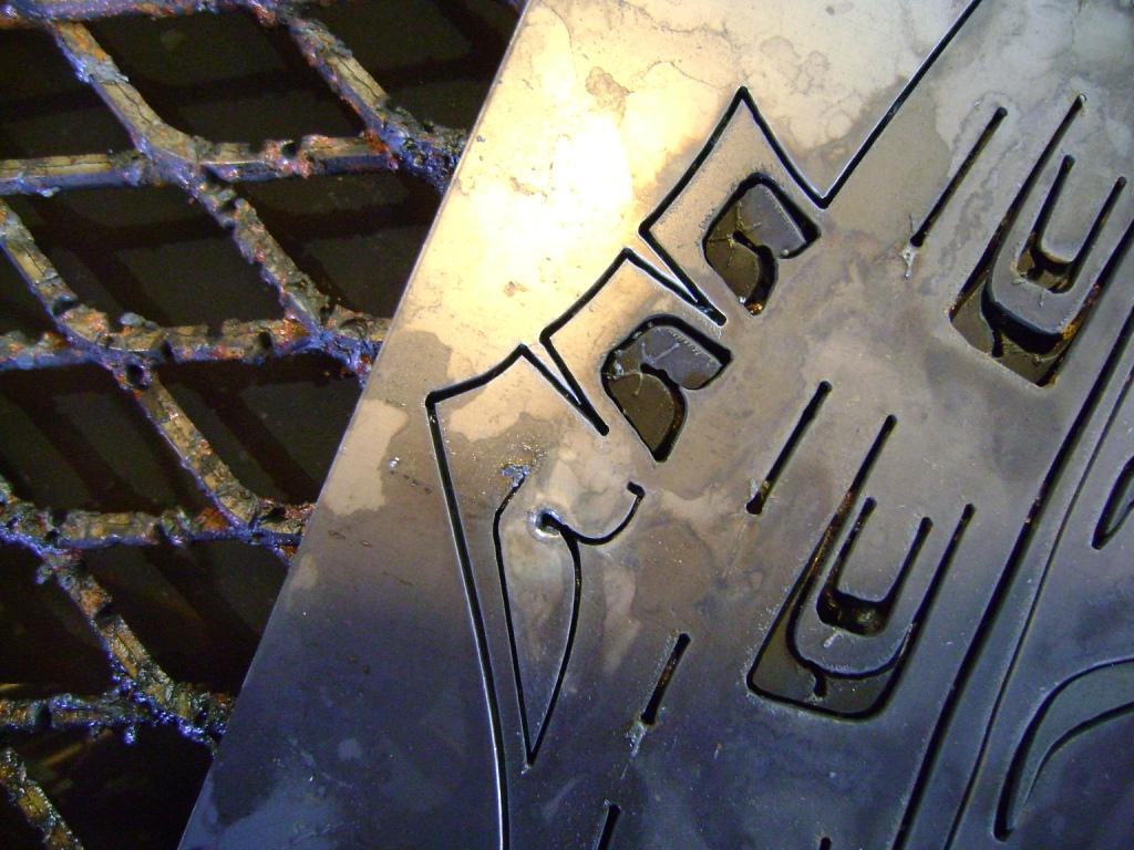

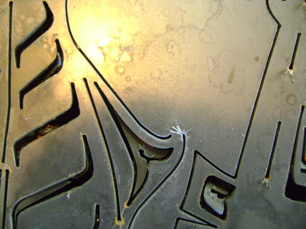

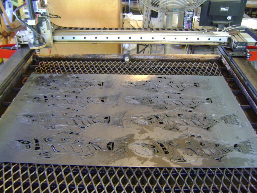

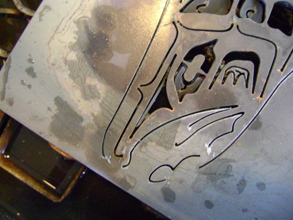

24 Apr 2018 04:09 #109528 by islander261
Replied by islander261 on topic Wandering Z zero
Well as promised here are some photos of the problems. In the end I only had to resort to the die grinder cutoff disks for one part of of the whole sheet.
John
