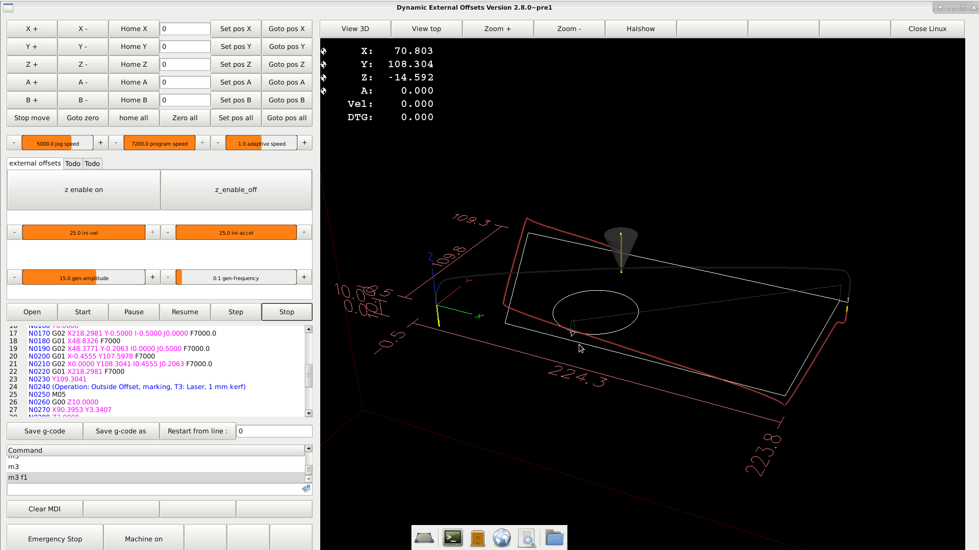

04 May 2018 13:41 #110200 by Grotius
Hi Rod and John,
I god it working, amazing !!
It was a few hours programming work.
I had a little error in the home sequence to solve in my grotius program, had to use c.home(-1) on this linux 2.8 pre version.
Step by step i transformed the standard axis config to the grotius config. At this moment the sinusgenerator is working fine.
At this moment i try to write some code to enable / disable the sinusgenerator. And enable / disable torch up and down signal
for proma thc. After that is working i must make a real time modbuss driver to load in hal. My current modbus i/o over the
user interface is far to slow for thc correctoins. B)
I made a short video. external offset first test
