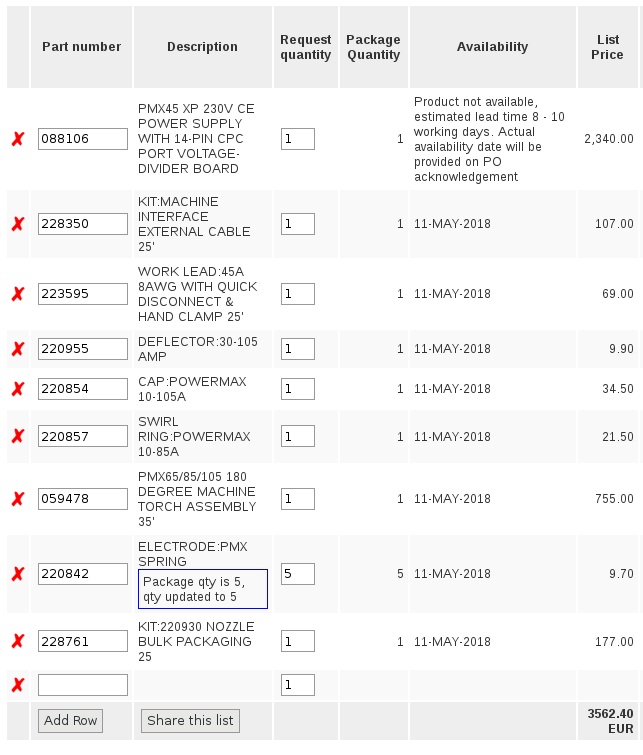

@Rod,
For your machine i think this would be practical the best setup :
088106 inverter 230vac with cpc port or (088107 inverter 230vac with cpc port and serial interface port)
223595 work lead 7.6m
228350 cpc interface cable to pc (with serial, you need separate serial connect cable)
059478 duramax machine torch 10.7m
And you need a retaining cap, deflector, swirl ring, electrode and nozzle.

Thank you. I've asked my local dealer for a quote based on your list. 2500 EUR is about what the 088139 kit with torch, CPC and RS485 was quoted at.

The local dealer came back at AUD $4009 excluding our GST (VAT) for the full Grotius lIst. Google currency converter makes that about 2538 Euro. I think imports from Europe would require about AUD 100 customs fees plus 5% duty plus Customs broker fee (plus out 10% GST).

Hi rodw,
Okey that is a nice price. Dealer has i think 10% on 2200 euro if they are gold supplier.
So for 3 years warranty i would not complain about 2500 euro's.
Remember for your consumables, go to borte. They are really cheap. They even sell the patended hypertherm electrode.
They don't give a shit about that. This cost's my all my consumable clients. But Hypertherm know's about that.
