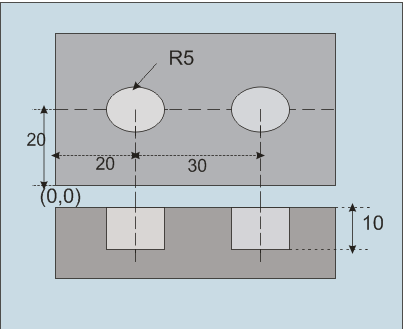

G82 DRILLING CYCLE
- harshal
- Posts: 4
24 Aug 2018 11:10 #116527
by harshal
G82 DRILLING CYCLE was created by harshal
www.hdknowledge.com/2018/08/how-do-i-pro...-drilling-cycle.html
O5124
N10 M06 T04 ;
N20 G90 G80 G17 G00 G54 X0 Y0 ;
N30 G43 Z100 H4 ;
N40 M03 S1500 ;
N50 M07 ;
N60 G99 G82 X20 Y20 Z-10 R5 P1000 F120 ;
N70 X50 Y20 ;
N80 G98 G80 G00 Z100 ;
N90 M05 M09 M30 ;
O5124
N10 M06 T04 ;
N30 G43 Z100 H4 ;
N40 M03 S1500 ;
N50 M07 ;
N70 X50 Y20 ;
N90 M05 M09 M30 ;
