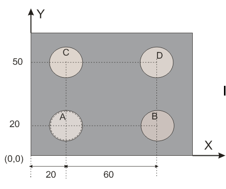

Fanuc G81 drilling cycle
- harshal
- Posts: 4
24 Aug 2018 11:14 #116528
by harshal
Fanuc G81 drilling cycle was created by harshal
www.hdknowledge.com/2018/08/how-do-i-mak...-vmc-cycle.htmlO5124
N10 M06 T06 ;
N20 G90 G80 G17 G00 G54 X0 Y0 ;
N30 G43 Z100 H4 ;
N40 M03 S1500 ;
N50 M07 ;
N60 G99 G81 X20 Y20 Z-45 R5 F120 ; [A]
N70 X80 Y20 Z-45 ;
N80 X20 Y50 Z-45 ; [C]
N90 X80 Y50 Z-45 ; [D]
N100 G98 G80 G00 Z100 ;
N110 M05 M09 M30 ;
