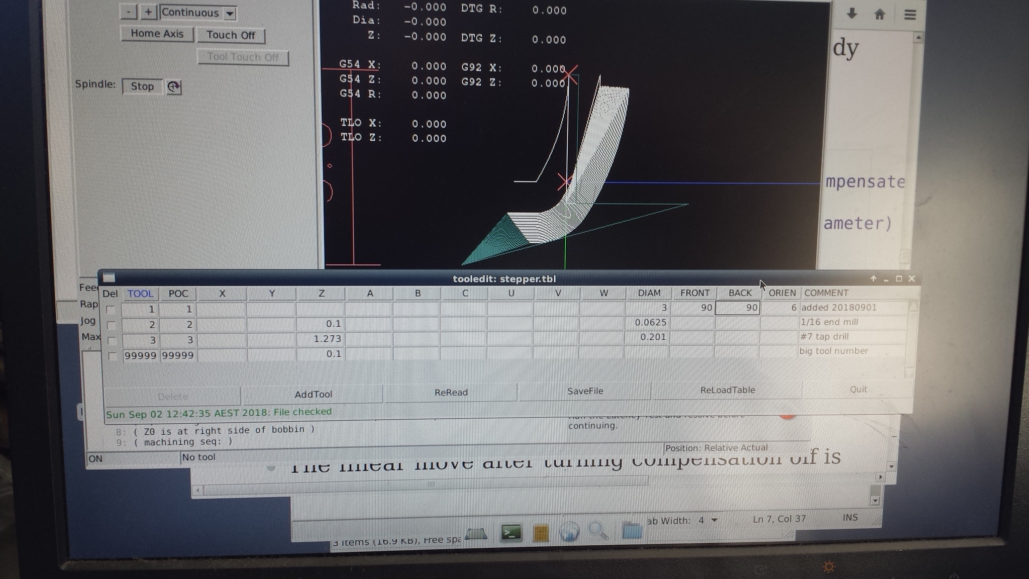

In lathe mode I cannot get the tool to show or show correctly.
It just shows the triangle arrow or nothing.
When I first used it after installing, I was sort of able to see the tool correctly.
Suddenly it stopped and no matter what, I cannot get it to work again.
I have tool 1 3mm diameter.
It used to show nicely as a circle.
I then had angles 90 and 90.
Even that showed correctly as a half round tool.
The orientations never worked as per documentation though.
Right now it does no longer work at all
What can I do?
Regards
Bernt

Your Axis screen shows that you have no tool loaded at the bottom of the screen. You need to load a tool with T1 M6.

Yes, but that is not it. The program does load the tool. It just was not because I reset it before the screenshot.
It all has to do with the tool orientations in that tool table by the look of it.It is just not working correctly at all.

if front and back angles are identical then you have a zero-angle tool which will be rendered as a line of zero width.
Angles are measured clockwise from the Z axis, so a typical CNMG holder will be frontangle 85 backangle 5

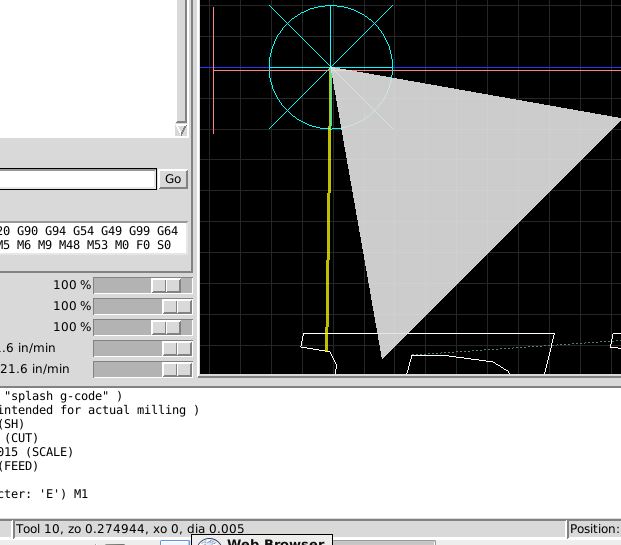

Just tried this out on 2.7.14
T0 M6. I get the default cone.

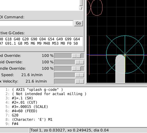

T1 M6. I get a parallel tool with a radius on the end (it's a parting tool) (orient=1)
T10 M6. I get the triangle representing a typ outside sharp tool (orient=2)

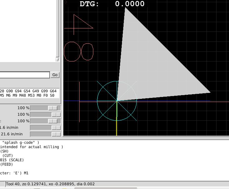

T40 M6. I get the triangle representing a typ sharp boring tool (orient=3)
So it still seems to be working as I think it should (and I think Bernt thinks too!) in 2.7.14 for me at least.
