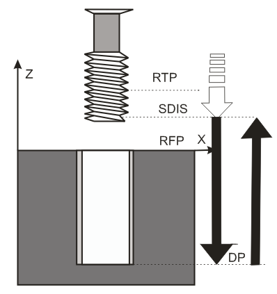

rigid tapping program
06 Sep 2018 08:16 #117140 by harshal
rigid tapping program was created by harshal
HARSH.MPF
N10 G90 G71 G94 F200 ;
N20 T03 D01 M06 ;
N30 S1000 M03 ;
N40 M08 ;
N50 G00 X25 Y10 Z10 ;
N60 CYCLE84 ( 10 , 0 , 2 , -25 , _ ,_ , 3 , 5 , _ , 90 , 200 , 500 , 3 , _ ,_ ,_ ,_ ,_ )
N70 G00 X25 Y35 ;
N80 CYCLE84 ( 10 , 0 , 2 , -25 , _ ,_ , 3 , 5 , _ , 90 , 200 , 500 , 3 , _ ,_ ,_ ,_ ,_ )
N90 M05 M09 M30 ;
more info- www.hdknowledge.com/2018/09/how-i-learn-...d-tapping-cycle.html
