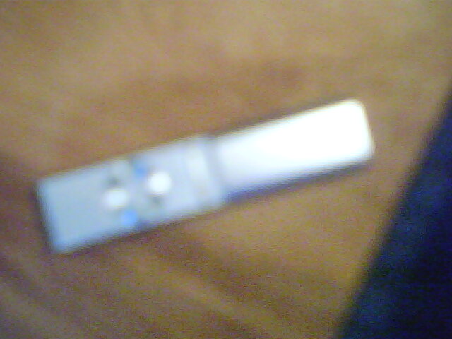

Hi Chris,
I have installed a webcam software called : cheese on linux with terminal command : sudo apt-get install cheese
It's a very bad webcam, you can see at the picture that i took of a tv remote control pendant.

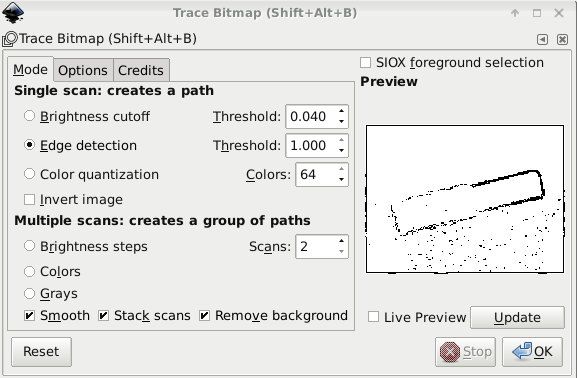

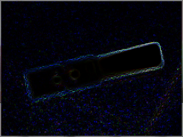

Then in the cheese software you can do edge detection, then you got this :
Very bad output.
In the end i got something in inkscape to produce g-code
I will try to get a better webcam.

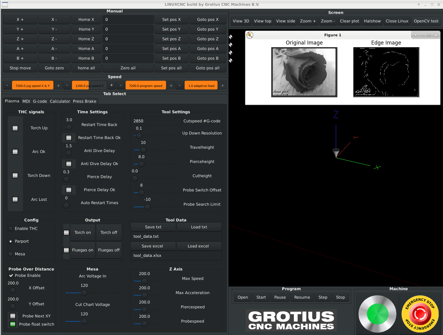

Hi Chris,
I did install opencv on the command line :
sudo apt-get install python-opencv
sudo apt-get install python-matplotlib
in the grotius gui i added in the top level :
And i made a testbutton in glade ;
The file i used for example was a rose.jpg file.
So openCV it altready working in the linuxcnc gui within short time.
I like this.
My first test with openCV is based on this tutorial : opencv-python-tutroals.readthedocs.io/en..._canny/py_canny.html
For today i ended with : matplotlib.org/users/image_tutorial.html
I think the matplot library has more opportunities to picture position's usable for cnc machine's.
The picture has x and y coordinates.
Tomorrow i make a clean github gui for this.

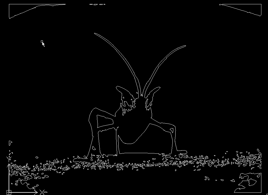

Update :
This line converts a bmp file into a dxf directly in linuxcnc :
def on_OpenCV_test_pressed(self, widget, data=None):
load = subprocess.call(['/usr/bin/potrace', '-b', 'dxf', '/home/grotius/linuxcnc-external-reverse/configs/sim/grotius/stinkbug.bmp', '-o', '/home/grotius/linuxcnc-external-reverse/configs/sim/grotius/stinkbug.dxf'])In the top of the python file :
import subprocess
from subprocess import call
The output picture of the dxf file in draftsight :
This is nice to have. We go to the next step now.
This code is behind a user gui button and is ready in about 0.1 seconds.
