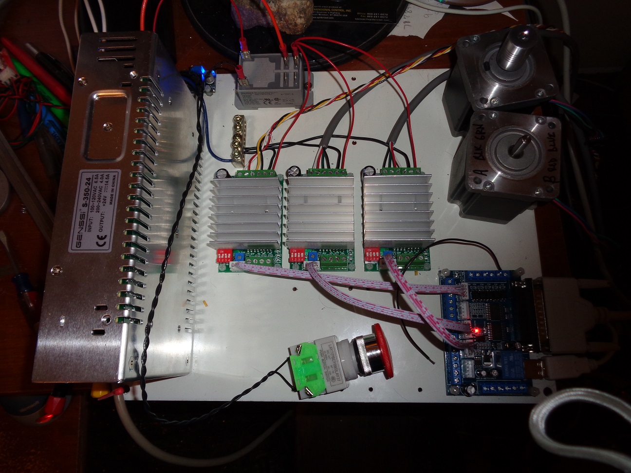

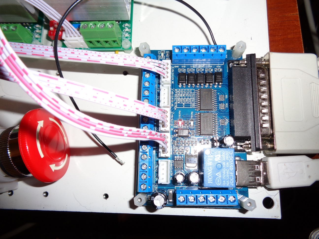

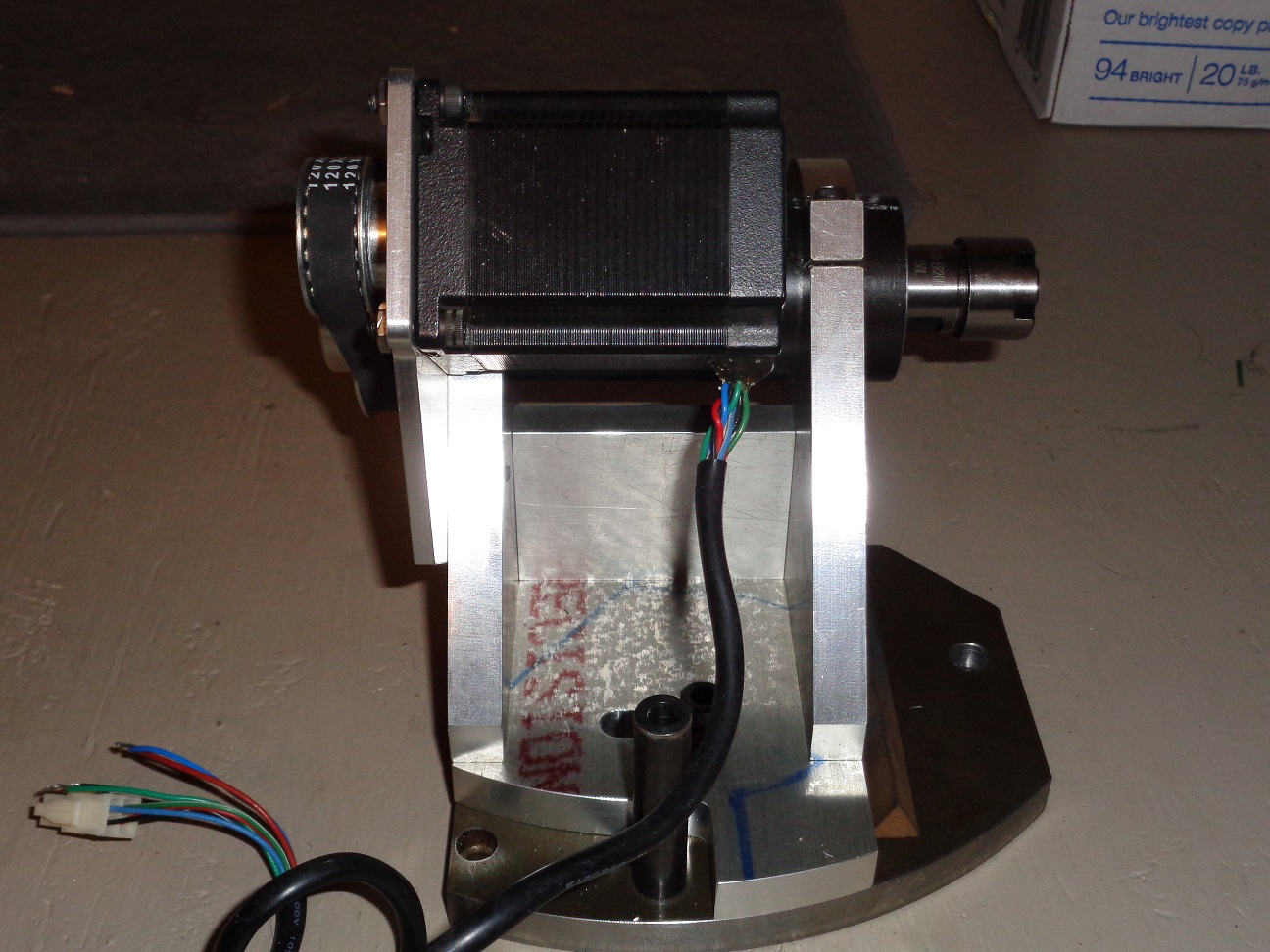

Ok my first problem is that I have not correctly addressed the enable command on the work head which is a stepper. Please find the hal and ini files and photos of the work head.
Can someone look at the files to see what I did wrong.

06 Nov 2018 13:33 #120102
by markd
Replied by markd on topic Need some ideas on how to set up a home built OD/cam grinder
The Photo was skipped
06 Nov 2018 16:12 #120106
Replied by andypugh on topic Need some ideas on how to set up a home built OD/cam grinder
I think it skipped the files too, they both seem to be 0 bytes.
Does the workhead stepper lock when the system is enabled?

I will try again. I did not mention it before that I am using a 5 axis bob with the work head on the A axis.

06 Nov 2018 21:22 #120118
Replied by rodw on topic Need some ideas on how to set up a home built OD/can grinder
Most stepper drivers include an enable connection. What is rarely made clear is that by applying a voltage here, you are actually disabling the stepper, not enabling it. So if you have connected a wire to this signal, try removing it.

06 Nov 2018 21:30 #120119
by markd
Replied by markd on topic Need some ideas on how to set up a home built OD/can grinder
Thank you for the reply.
The stepper is wired the same as the X and Z steppers which work.
When I use the unaltered config files (which sets the work head up as a Aaxis it works fine. The enable pin is the same for all of the axis.
