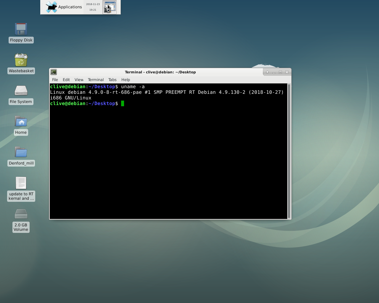

Is this the 32 bit Stretch ISO image?
www.linuxcnc.org/testing-stretch-rtpreem...-uspace-i386-r13.iso

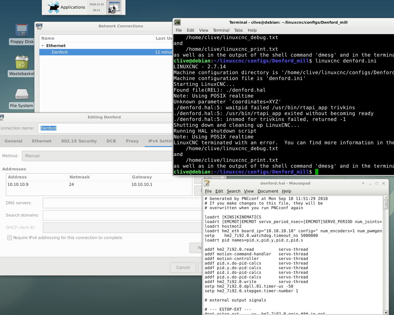

The errors don't seem hardware related, is it possible you are using a hal/ini file from a different LinuxCNC version?

Replied by tommylight on topic linuxcnc stretch 32 bit with mesa 7i92
How old? i have some 6 or 7 year old ones running Debian Stretch or Linux Mint 64 bit with Preempt-RT quite nicely.
That should work as it requires Preempt-RT of the kernel, not 64 bit versions.

Replied by Clive S on topic linuxcnc stretch 32 bit with mesa 7i92
Yes that is the version
Yes I am using the hal and ini files from the 64 bit version
I did not realise that the two version were different. What are the main differences.

Replied by PCW on topic linuxcnc stretch 32 bit with mesa 7i92
Theres no difference in the hal and ini files for 32 or 64 bit LinuxCNC
I was thinking maybe a 2.7/2.8 issue

So I might need to start from scratch with a new config. Does the version I am using require userspace?
I never thought about that. I will check it out tomorrow.Theres no difference in the hal and ini files for 32 or 64 bit LinuxCNC
PCW :wrote Theres no difference in the hal and ini files for 32 or 64 bit LinuxCNC
Yes that was the reason I had to alter the hal and ini files to the 2.7 standards.
Everything Ok now. Thanks for the pointer.
