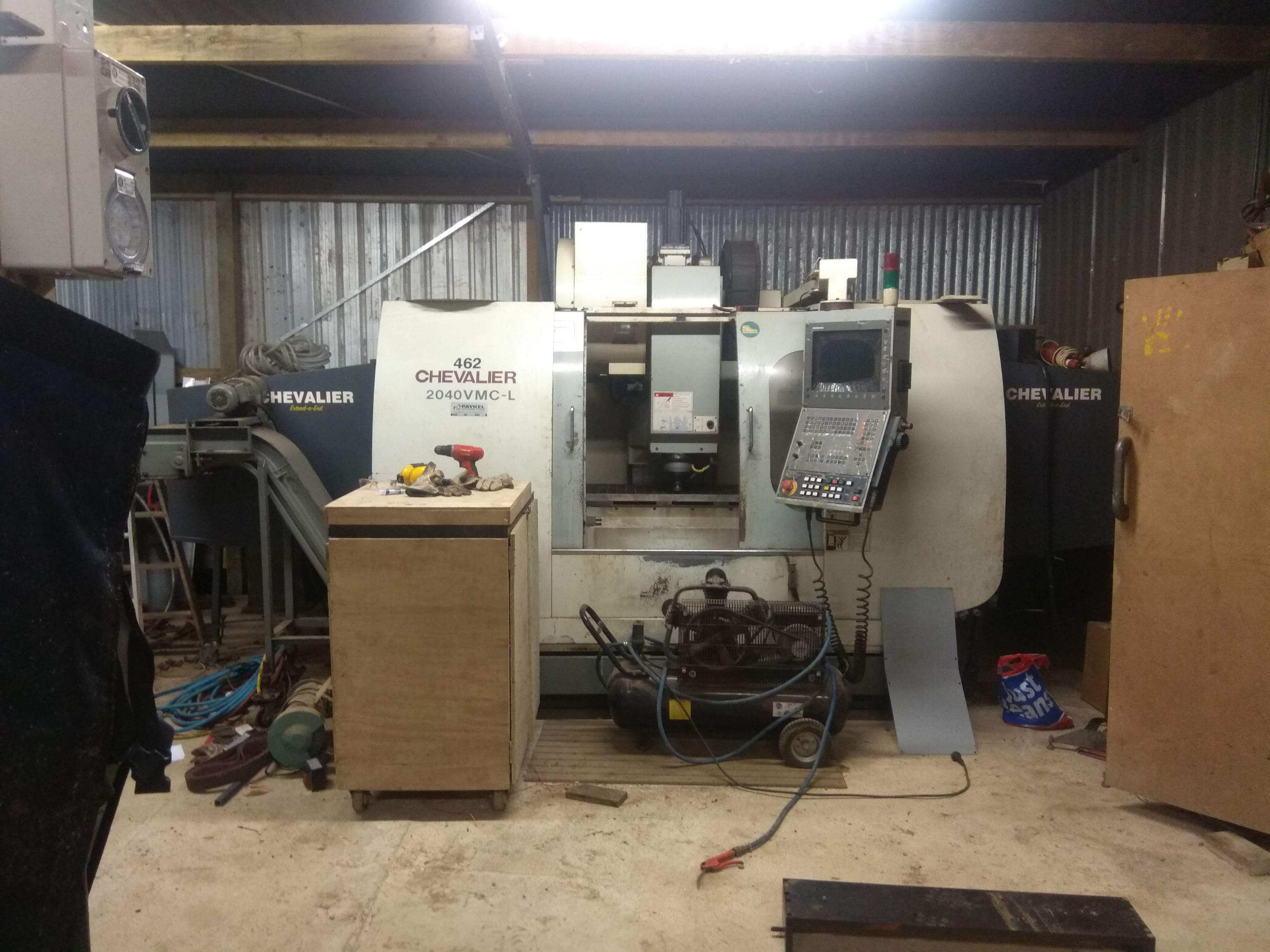

Last year I bought a Chevalier VMC from a local company with the intention of fixing it or else just completely retrofiting the beast.
It was made in 2001 so relatively late model compared to most out there and was in really nice mechanical condition. Plus it comes with all the goodies like a 10 k rpm spindle, spindle cooler and 24 tool changer. The machine had a power strike which took out the combined servo and spindle drives unit. everything else works fine. I have given up fixing it and want to just retrofit with linux cnc and have a bit of fun learning while I do it. I also have 6 weeks off from the 6th of dec to concentrate on this, so will have a nice chunk of time.
here is the machine:
So currently I have a servo drive and 5000 ppr encoder coming in from china and I will be trying to reuse the heidenhain servo motors and just fix new encoders to them. I will try get one motor working before starting on the rest.

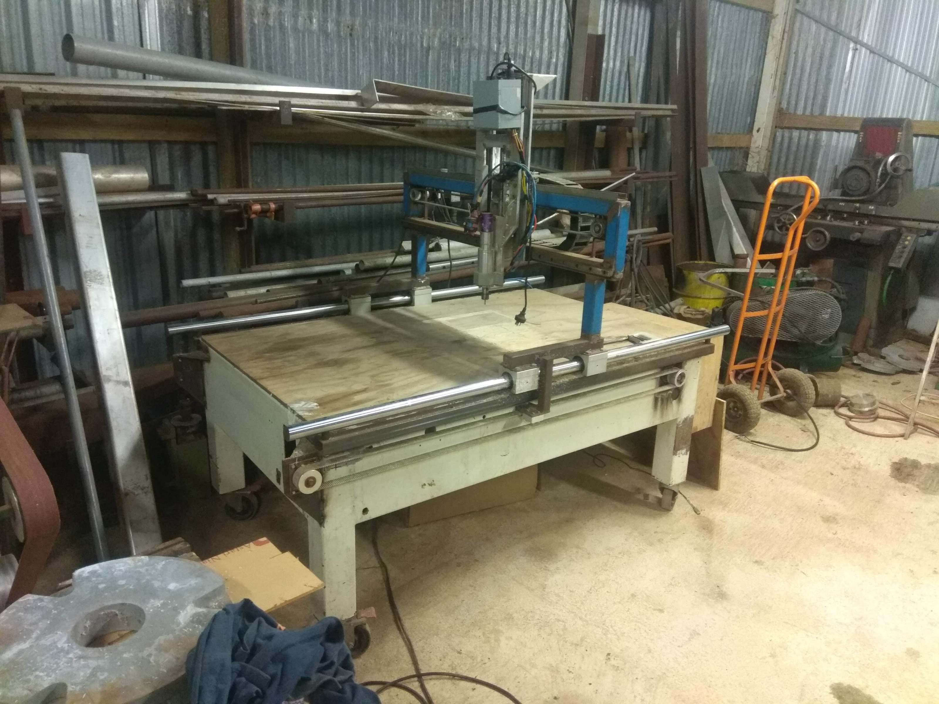

It would be relatively simple to cut your teeth on Linuxcnc by setting up the router. You would probably only need a parallel port breakout board for that.
There you could familiarize yourself with Linuxcnc and how to configure it.
Then tackle the VMC. I would strongly encourage trying to salvage the existing servos and drives for that machine. At the very least reuse the old motors (they are unlikely to be hurt.) What brand servos did it have? What was the old control? A machine like that is likely to require 3ph electric, do you have that available in your shop? Sometimes resurrecting an old machine like that is as simple as replacing the controls back up battery and reloading the machine parameters. (but that can be a big task if you don't have and can't get the backup files.)

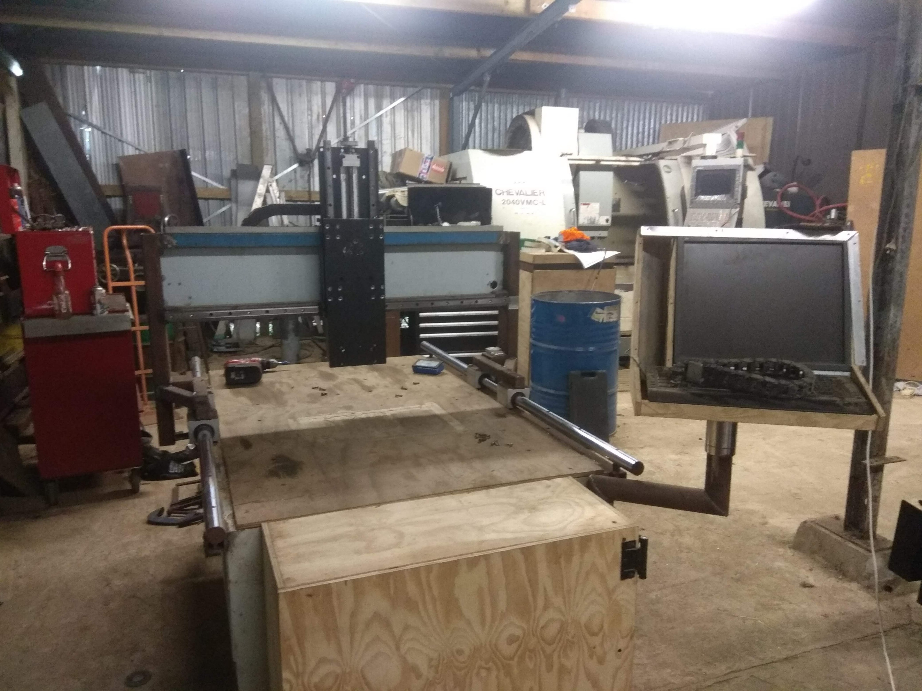

My Cnc router is now working and cutting air fine when I send it a fusion360 gcode file. I just need to set up the spindle and I am away cutting. And I am just about to make a start on my big cnc mill now.

So I have the router working with correct homing and everything else and cutting air, just need to wire up my spindle and I can cut parts. I am pretty happy with the router really. Linuxcnc works very well. It was pretty hard to find info about how to set up my system but I finally nailed it.

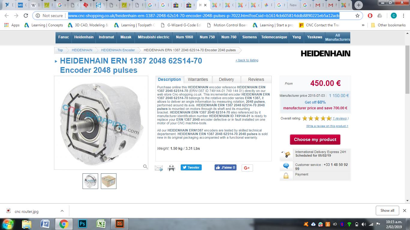

I want to reuse my heidenhain encoders if I can. Now I have done some research and I think that I have standard incremental encoders with 2048 pulses per rev. My encoders are the same as this link.
Link to same model of encoder as I have.
Can someone please confirm that these are standard TTL incremental encoders. I don't want muck around for ages because I have a absolute encoder or a sin/cos encoder which I think I can't use?

The encoders seem to be 1V peak to peak:

What does that really mean AndyPugh?
I am also concerned with the fact that they are sinusoidal and might be hard work to interface with..
