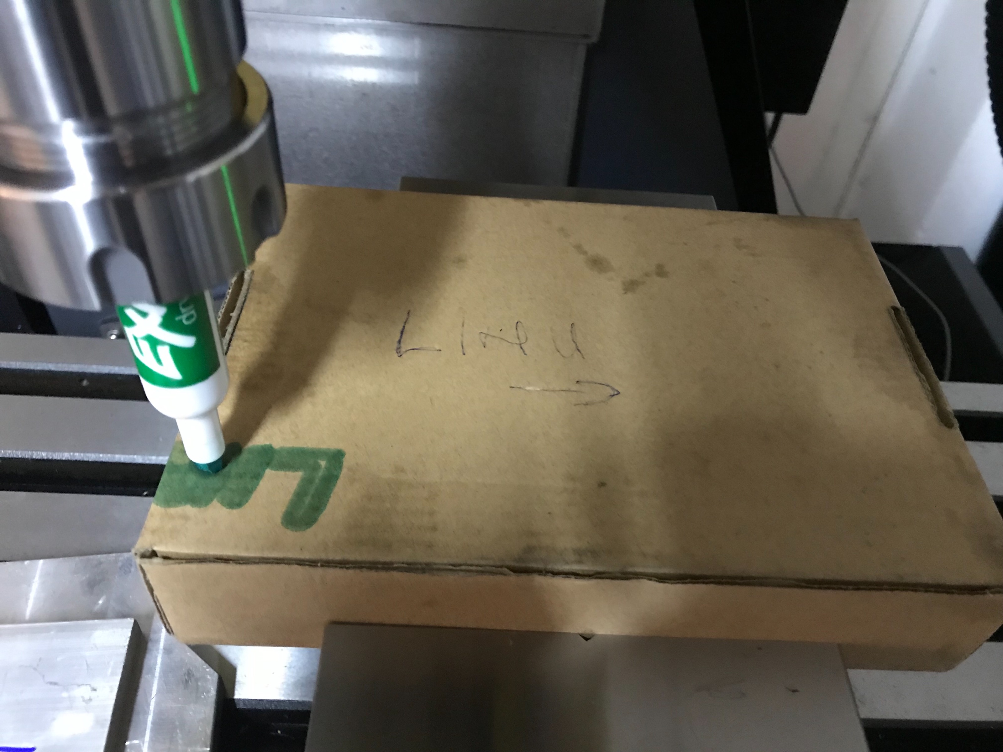

Hi guys,
Before doing test cuts I wanted to try the default linuxcnc program, the one that engraves linuxcnc.
I removed the spindle command and I put a marker in the spindle.
The texs is written upside down and in the wrong direction.
Any idea why this happens?
If i jog from the pendant, the axis movement directions are correct.

It looks like you have a moving table arrangement. You need to remember that movements are supposed to be of the spindle relative to the workpiece. So if your machine moves the work piece and not the spindle the movemint will be opposite of the arrow on the keyboard. So a positive X move (right keyboard arrow) will move the spindle to the right of the work piece, or if it is the work piece moving, it will move to the left.

Having the table move in the direction of the arrows on the keyboard is opposite the normal convention. (You need to imagine the movement as if you were moving the spindle not the table.)

My machine is also a moving-table.
Look at the tool when you jog and it all feels natural.

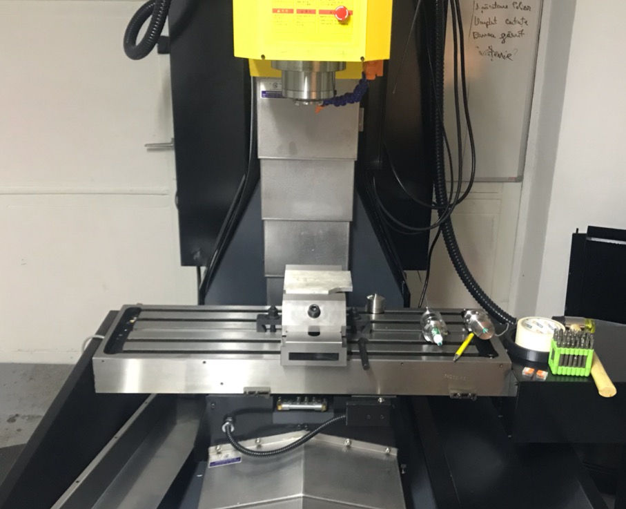

Might be a simple task for many, but a month ago I have crashed the machine on X while trying to tune the homing, and when you have 1kw servo per axis..its not funny at all..
Please see the settings I have now, with X moving in the wrong direction, not relative to the spindle. If i change the sign of Step_scale, how do I need to change the other values so that the homming will back off to the middle of the table and the dro to show +200mm
Here are my current values, with the axis reversed. With trial and error, I have managed to tweak the homing and soft limits. However, after its homed, the dro still does not show values between 0-390, it shows smth with minus.
HOME = 200.0
STEP_SCALE = 400.0 (this one needs to be with minus in order to refer to spindle movement relative to the table)
MIN_LIMIT = 2.0
MAX_LIMIT = 392.0
HOME_OFFSET = 0.0
HOME_SEARCH_VEL = -30.0
HOME_LATCH_VEL = -0.5
HOME_FINAL_VEL = 0.0
HOME_USE_INDEX = NO
HOME_IGNORE_LIMITS = YES
I have a single switch per X axis and two trigger pins. See the mill picture.

30 Jan 2019 14:19 - 30 Jan 2019 14:23 #125289
Replied by Todd Zuercher on topic LinuxCnc default program is being engraved upside down!
Is the home switch also the left limit switch? If you want your home switch to be with the table moved all the way to the left that would be at the positive limit of travel. and your table has 400mm of travel. If you set your "HOME_OFFSET = 400" and "HOME = 200", I think you may get the results you desire. (You may also need to change the signs of your scale, search vel, and latch vel.)
"HOME_OFFSET =" sets the position value of the point where the home switch is triggered and "HOME =" sets position where the axis moves to and parks at the end of the home sequence.
