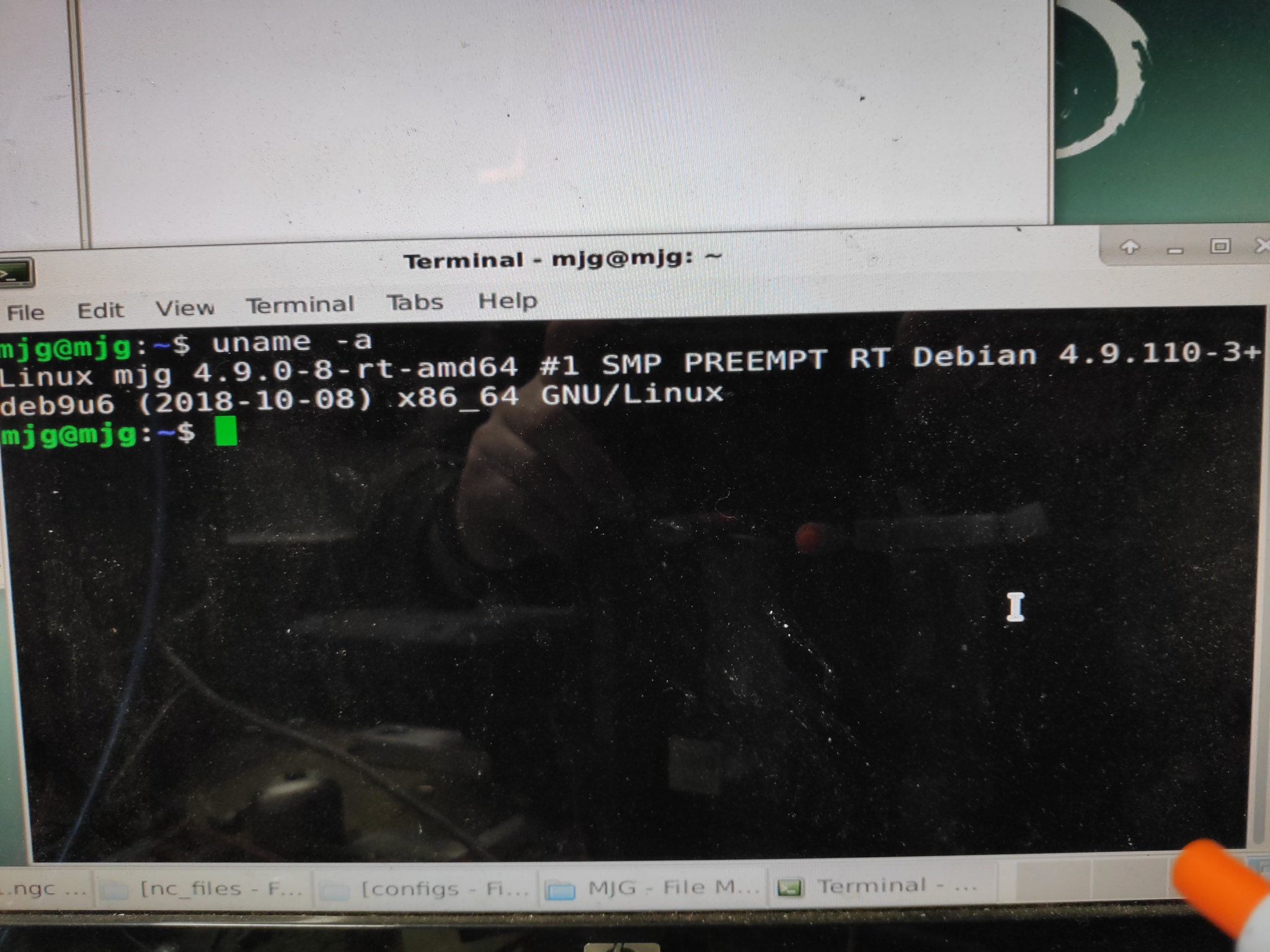

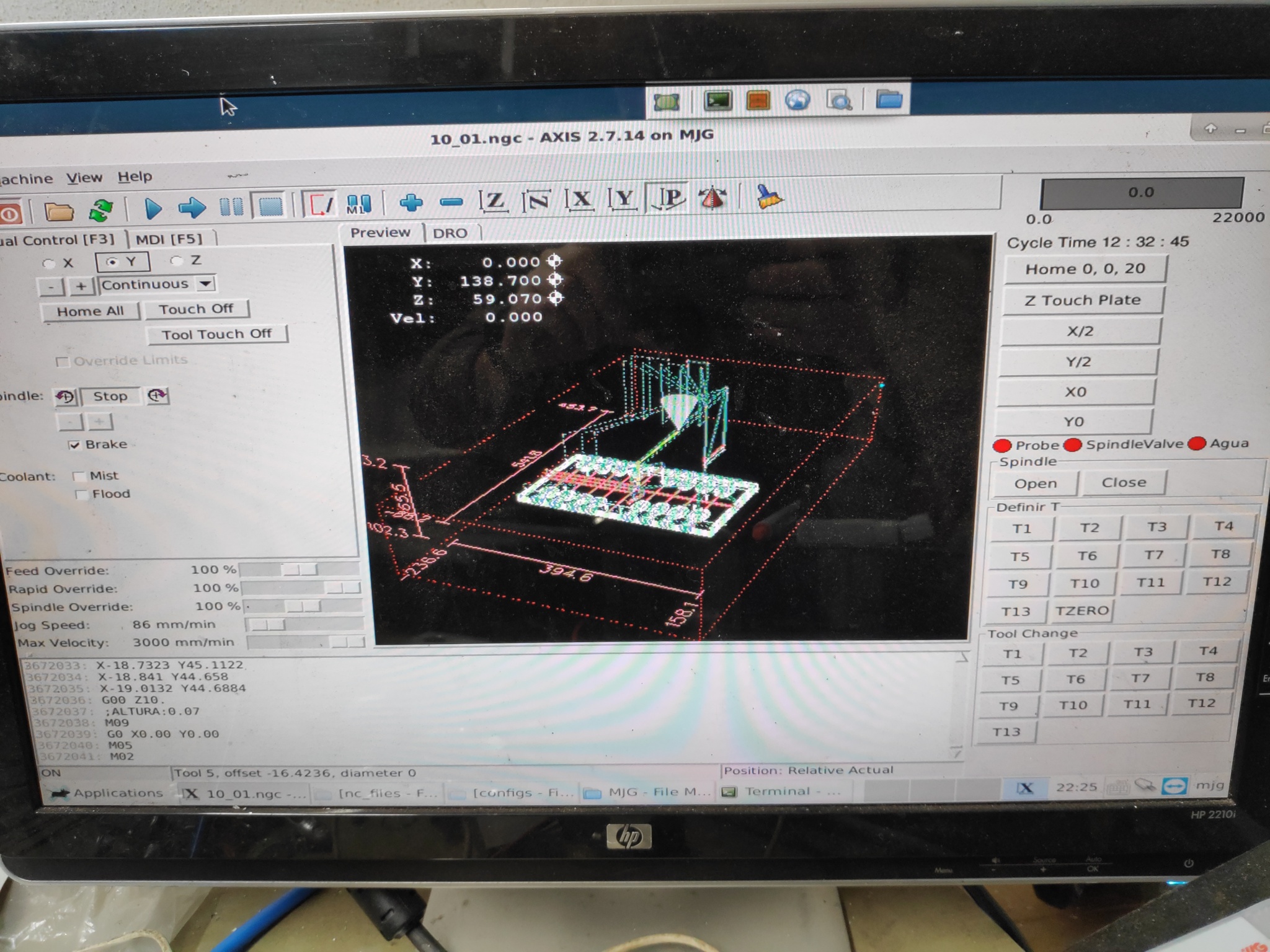

for me its doing task at the moment at F500
Wow. I am running on Ethercat... So very fast protocol.
Is your linux 64 bit?
Do you use servo thread or only base thread 15000?

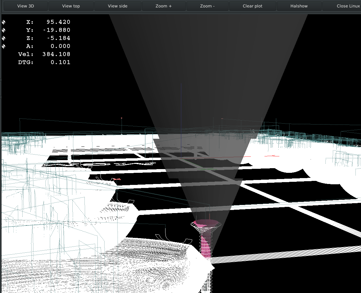

In your program you are at line 3.6 miljion...
i use 64 bit. You also i see, nice work.
I tested to only use base thread tonight. Never did that before. Just followed the basic ethercat config's but that solved not my problem.
I had to tune ethercat steppers for using it with pulse output module instead of pid.
Servo threat was way to slow for that. Just like parport uses the base thread for real time pulses.
I think your program run's stable, but your internetting goes little slower while running such a huge program.
So 3 miljion lines is no problem at all.
Maybe you can increase the speed by using offset's. I see you have the same product 16 times. By using offset's the speed
will increase dramitically. Welcome to the world of subroutines.
The gremlin goes good. It's now making a screw.

Did you try disabling the preview and backplot?
This should make a huge difference with so large a program

I have passed this program today, tomorrow or Wednesday i have a new one to pass and try to disable backplot.
The problem is not opening a big program is at the end of so much working hours
Replied by MarcoGaspar on topic Linuxcnc getting very slow
