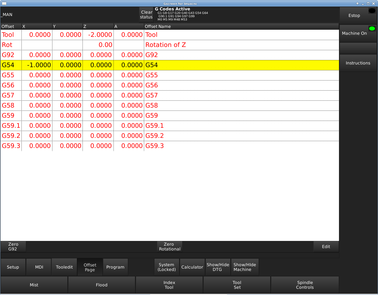

Thanks Again Chris, That worked great .... I tried to apply the same logic to the tooledit1 widget because the background for the tool editor is black as well but it didnt work.

Replied by cmorley on topic Gcode window text color change Gscreen
style "tooledit" = "default"
base[NORMAL] = "#d7d7d7" # background color
bg[NORMAL] = "#d7d7d7" # header color
text[NORMAL] = "#000000" # text
widget "*.*.tooledit*" style "tooledit"It seems the the parser didn't like the '1' in tooledit1 for I used a wild card.
resizing widgets is specific to the layout/settings used to contain the widget.
widgets can be made to use as much space as possible or to always be one size etc.
I would need to see the code/glade file to be more specific.
Chris M

I thought I was finished with it .... finally, but when I went to edit a Gcode file , the Gcode editor widget exhibited the same problems with background color etc. etc. as the tool edit page and offset page I attempted to apply the previous logic to the 'gtkrc' file for a widget that I thought was the Gcode editor but it didn't function as expected. Is there anything different with that particular entity ?
Do you know how I can adjust the colors of the Gcode editor ?

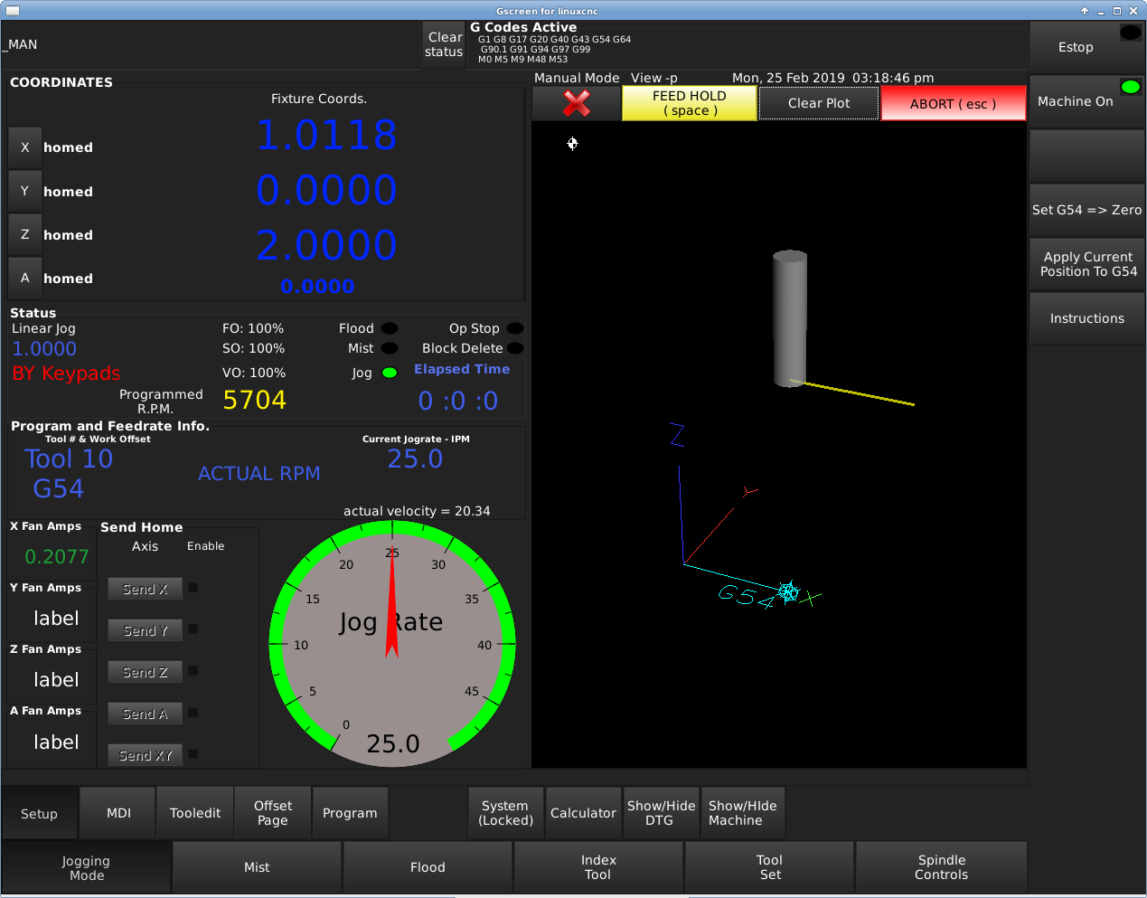

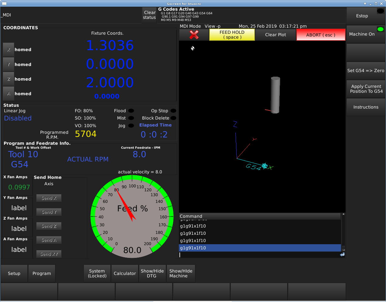

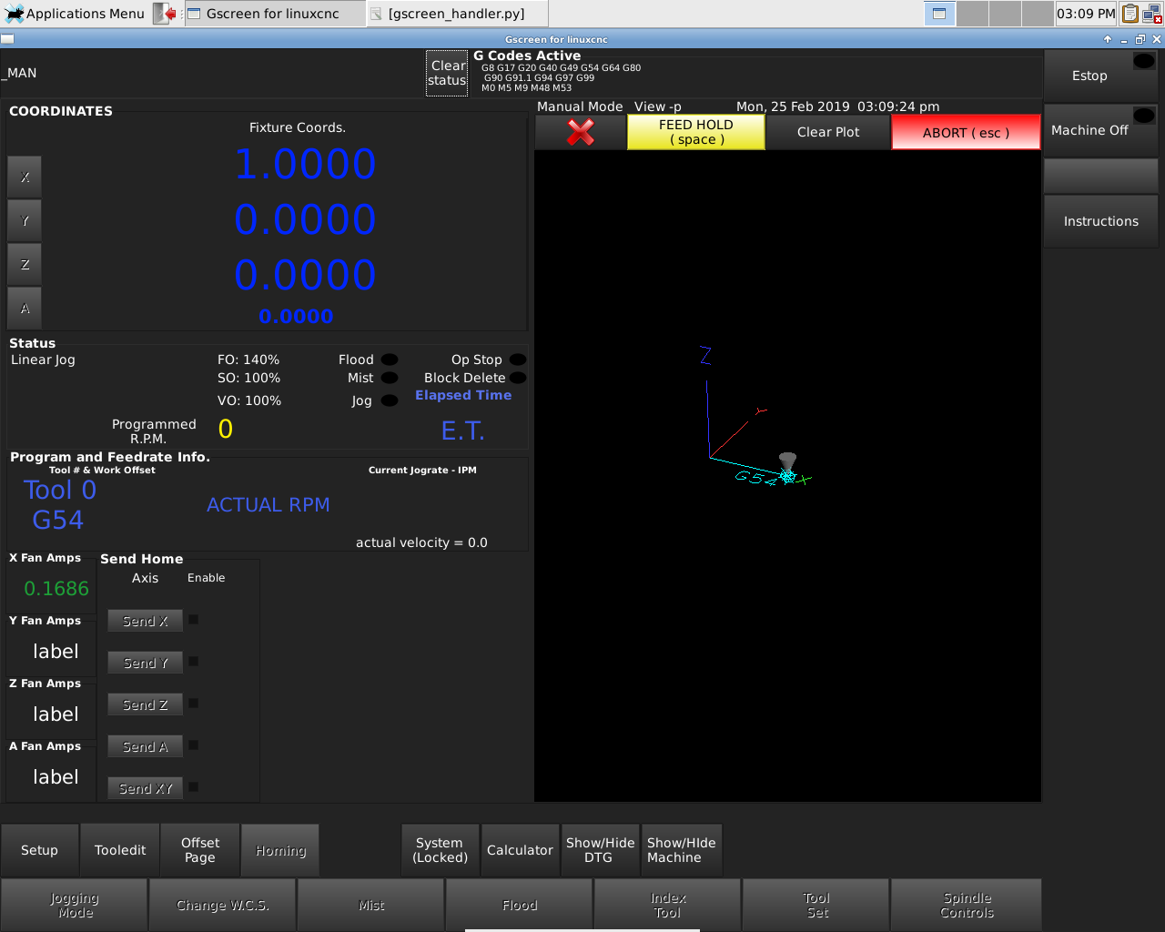

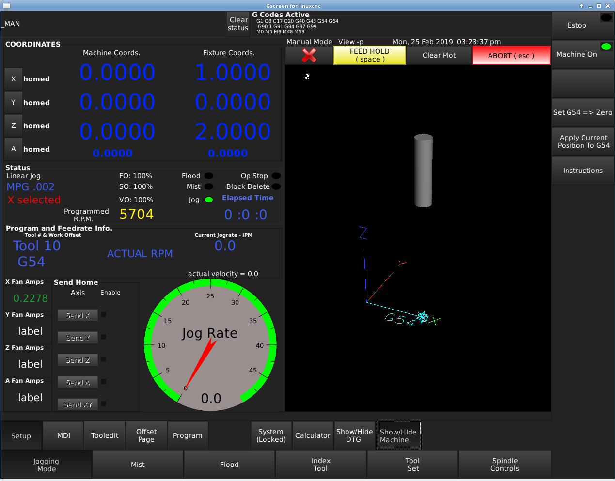

Anyways, attached are some pictures of the GScreen GUI that I've been working on for quite some time and I really need to thank you for writing it. I appreciated the layout because it wasn't "busy" and offered a great base to expand on to suit my needs. The code that you wrote was pretty easy to follow once I learned the basics of Python and before Gscreen I had never even laid eyes on that programming language. It contained all of the items that I needed in a very user friendly layout. The GUI I ended up with is also interfaced with an Arduino pendant that I'm right in the middle of finishing also. Between learning Python , Hal , Arduino & Serial communications its been a great learning experience.

26 Feb 2019 00:21 #127134
when the gcode view switches to edit mode the 'sensitivity' to input changes. GTK usually uses other colors for sensitive widgets. I added a couple more line to this entry in the gtkrc file:
I like your screen. Those couple light buttons add a little accent that is nice. Do you like the jograte as a meter display - I've never thought of that.
Thank you for the kind words. I am always impressed with what people can make with the tools I've knocked together!
Chris M

I like the large faced indicators because I can see them from a distance while using the pendant. Being that 100% of the programmed feedrate is always at 12 o'clock , I can quickly see where im at in relation to whats been programmed by watching the big red needle.
When im using the MPG, the larger dials work better for me because they actually show the current feed rate when im turning the wheel. i do a lot of tooling , fixturing and prototype work so i have a greater need for 'manual type' indicators versus a production machine where feeds and speeds are pretty much ironed out once then run that way forever.
