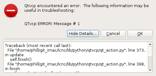

Tested with ngc, py and jpg filters and all works well with the exception of a couple of issues:
1. If multiple extensions are specified in the ini file (which does work in the axis gui) then when this entry is selected in the file dialog "Files of Type:" then no files with any of these extensions show up.I tried changing the comma for a semi-colon and also a colon but that made no difference.
Edit: I changed line 219 in qt_istat.py to:which seems to work ok.
2. If I inadvertently open a incorrect python file with something like:in it then it gives an error dialog:
The full contents are:
Cheers, Phill.
PROGRAM_EXTENSION = .png,.gif,.jpg Greyscale Depth ImageEdit: I changed line 219 in qt_istat.py to:
k = k.replace('.','*.').replace(',',' ')2. If I inadvertently open a incorrect python file with something like:
infile = sys.argv[1]The full contents are:
Warning: Spoiler!
File "/home/phill/git_imac/lcnc/lib/python/qtvcp/qt_action.py", line 373, in update
self.finish()
File "/home/phill/git_imac/lcnc/lib/python/qtvcp/qt_action.py", line 398, in finish
self.error(r, "".join(self.stderr_text))
File "/home/phill/git_imac/lcnc/lib/python/qtvcp/qt_action.py", line 403, in error
dialog = gtk.MessageDialog(None, 0, gtk.MESSAGE_ERROR, gtk.BUTTONS_CLOSE,
NameError: global name 'gtk' is not definedCheers, Phill.

25 Feb 2019 03:30 - 25 Feb 2019 03:31 #127082
Replied by cmorley on topic QtVCP gcode file opening
Ahh yes ok. 'GTK' - left over from porting from gladevcp...I will fix those.
keeping me honest..

25 Feb 2019 11:00 #127098
Ok I think I got those fixed now.
