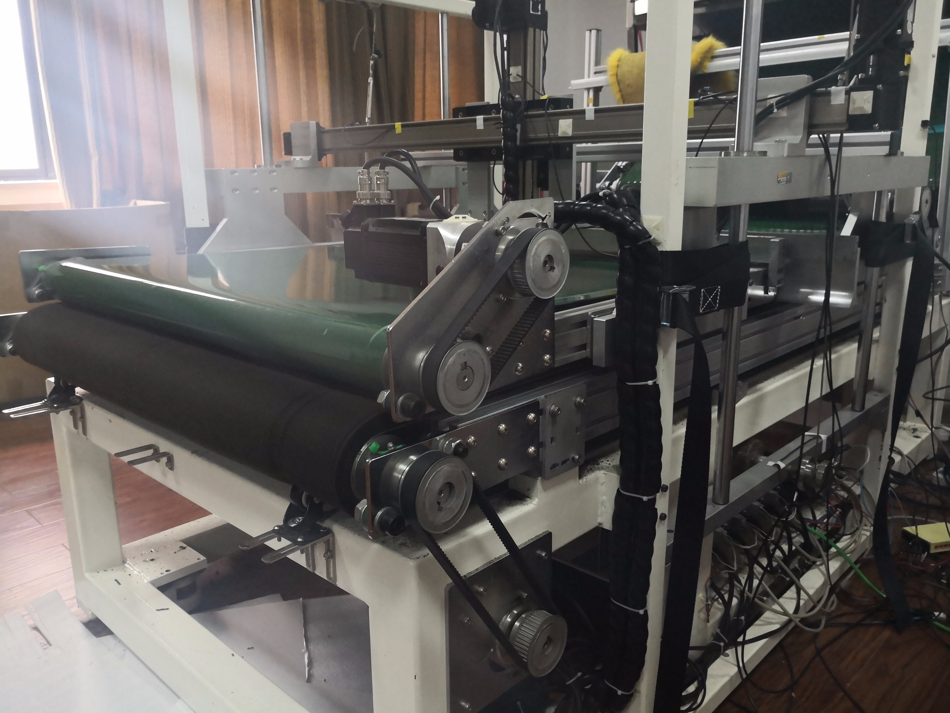

06 Mar 2019 02:55 #127858
by giantstone
Replied by giantstone on topic CNC Machine displacement error
by checking the test data, the error scale is very consistent in each different case,
thus i suppose the error is due to physical intrinsic attributes of the machine, instead of the controller board.
a photo of the machine is attached. the machine has two layers, the bottom layer has a sponge covered upon it.
right now the upper layer and bottom layer share the same motor scale config although the bottom layer has radius larger than the upper layer due to the sponge. During operation, the two layers squeeze together and move coordinatedly.

06 Mar 2019 07:45 #127866
by pl7i92
Replied by pl7i92 on topic CNC Machine displacement error
the layers are not equal in Thickness as the Sponche can squeeze
youmay consider 2 ROT encoders to the moving Band to get a feedback of movement

06 Mar 2019 14:21 #127886
by Mike_Eitel
Replied by Mike_Eitel on topic CNC Machine displacement error
Do I guess correct that your axis with the green "belt" is the one that gives you an error?
If you do not measure the real surface, I'm confinced that you will never get it precise.
One effect/reason is called trum ( in German... No chance to translate to English as word always replaced by a.....) other are thickness error, slipping, tention changes...
The only way would be some kind of roller, but that will have a slight slop or you go the marking way. Means you identify position on belt by either magnetic or optic strip.
I did a lot in that Metier when industrialized the digitran digital printing process. ( nope, not Kammann; they only bought the rest after we got broke)
Mike
Mike

06 Mar 2019 23:18 #127923
Replied by tommylight on topic CNC Machine displacement error
Circumference of a round is 2RPi or DPi i.e.
you have a round shape that is 100mm in diameter, multiply that by Pi or 3.1415 and you get the distance of the surface of that round, so 314.15mm
You need to do some math there to have the spin at the same speed.
Or do you intentionally need them to be separated and at different speeds ? I can not think of any idea why.

07 Mar 2019 02:45 #127940
by giantstone
i believe you made a great point,
the motor spin speed should always be the same for both the upper and the bottom layer.
That's probably why I'm having a error when ploting arc/circles using G02, G03 commands. I set the bottom layer Y axis, and the upper layer B axis, probably, G02/G03 only coordinates Y axis with X axis, thus B axis moves independently.
So, if there is a simple way to make G02 commands treat B-axis the same as Y-axis.
