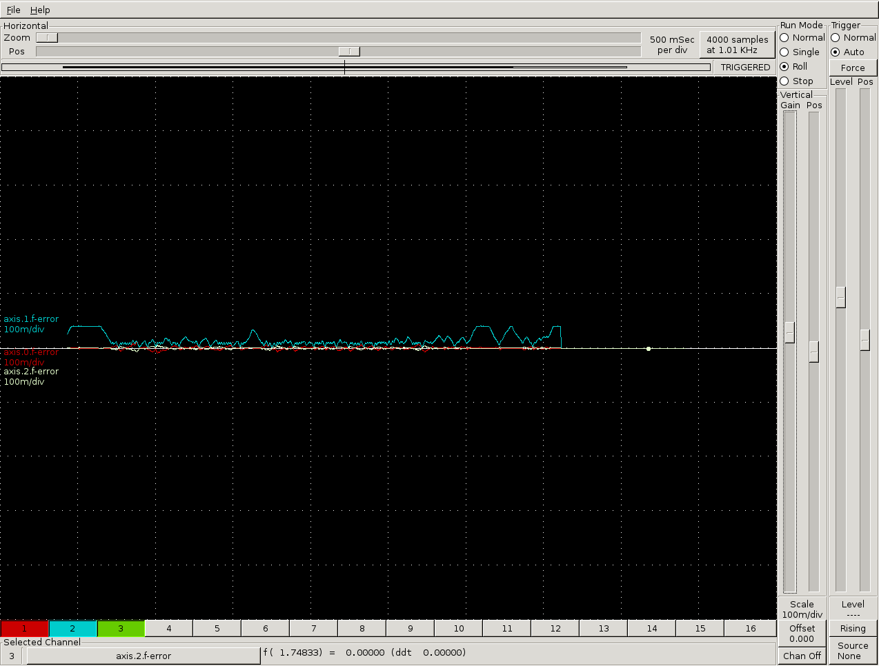

I've experimented further with joint velocity limits reduced to 100 mm/s (0.8 x step rate limit) but the following error values remain high. I've halscoped them (with raised f-error limits) to get a better picture. Here's a fairly large spike during one of the tricky jobs (an engraving task with a lot of small movements):
If I'm reading that correctly, the following error spikes over 0.5 mm (500 milli mm)!
Even when travelling at constant speed (at the speed limit), the f-error is around 0.04 mm:
How should I proceed? Is there still not enough headroom for stepgen? Should I lower MAX_ACCELERATION and/or raise STEPGEN_MAXACCEL? Would it be useful to scope the per-axis speeds along with the f-errors to see how they compare? Thanks!

I have seen some odd behaviour in the stepgen when close to the limits in the presence of jitter.
One thing that helps is setting the stepgen max-accel to about 125% of the maximum axis acceleration.
If you have backlash compensation enabled, stepgen maxaccel needs to be about 250% of axis acceleration
Can you post your hal/ini files? It may be something else going on

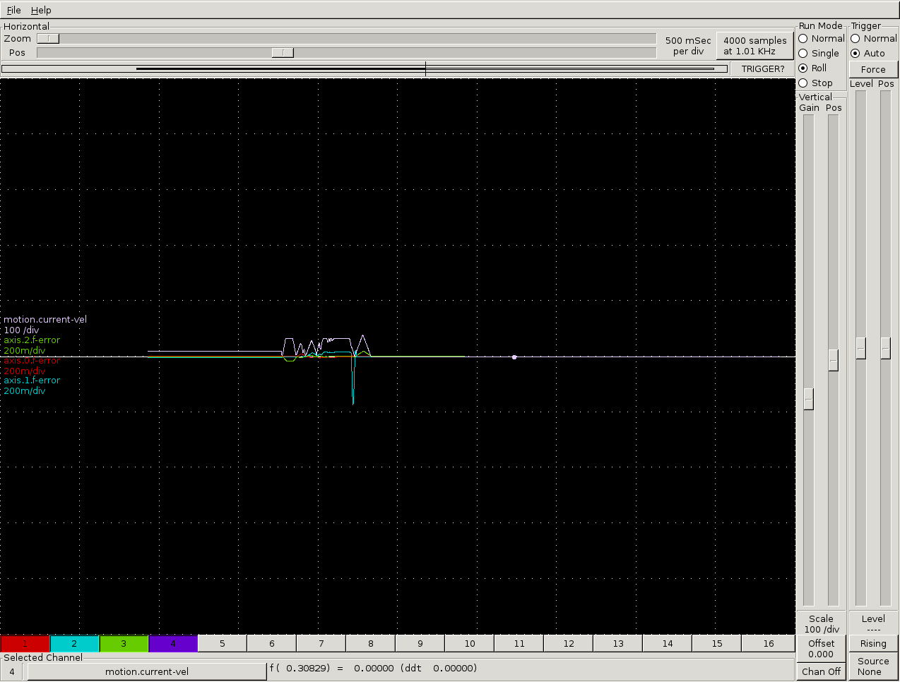

I've noticed that the f-error spikes seem to occur at (or just before) points where the velocity is low. I've tried to pinpoint where in the G-code this was occurring, and found that a particularly bad spot had three consecutive lines with the same co-ordinates. I wonder if these are confusing LinuxCNC's planner somehow. I also suspect that the steppers are losing steps at these points, as it makes quite a "clunk". Here's a cut-down standalone portion that produces a following error spike in the Y axis:
Here's a halscope snapshot of what happens at that point (note that the f-error is less here than in the full job, but is still quite dramatic):
Here's the current machine INI file (I've restored the speed and acceleration limits to highlight the problem):

Ahh... Pretty sure this is a known TP bug, I believe its been fixed but the fix is not merged
yet.
The bug is with crazy small blending settings (you have blending set to 1 micron)
2 microns fixes it for your sample code
yet.

Ah-ha - yes, that is crazy small! When I saw those consecutive moves to the same position, I realised I should try different path blending settings (particularly movement merging in the Naive cam detector), but didn't have a chance until just now. With G64 P0.01 Q0.01 it seems well-behaved, with following errors staying under 0.05 mm both at speed and at those redundant moves. With G61 it's also well-behaved (albeit with a lot of vibration!). But with fine path blending but no move merges, as you've gathered, it doesn't work out well. I wonder what's magical about the 2 micron threshold you found...but for now I'll get into the habit of specifying either G61 or G64 with both P and Q.
I should also contact the developer of the CAM tool I'm using to see if the redundant moves could be culled there.
Thanks heaps for helping troubleshoot this! Hopefully I'll be able to run a successful engraving job this week.
