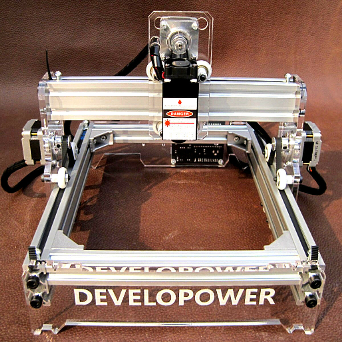

Brand new on the forum. I should start by saying that I know nothing about CNC. I bought one of these cheap Chinese laser engravers and found out that the software is Windows only. I have no Windows computers. I have been using Ubuntu for the last several years. I read somewhere that Linuxcnc could be used to operate these engravers. But just now I read that Linuxcnc does not support USB connections. The engraver is a USB Arduino control board. Any suggestions about software if no go on Linuxcnc?

It could possibly be running grbl github.com/gnea/grbl/wiki/Using-Grbl, it is worth an experiment trying to control it with one of the gui's written for grbl.

it will shure run wit thew K40 board or this very cheep laser nonames
all can be converted to standard parport
but you are looking for a Aduino grbl usb conversion
like estlcam
K40 Whisperer
like estlcam
K40 Whisperer

You could ditch the arduino and go with conventional stepper drives.

This is a
cheap set of stepper drives
. These either need to be connected to the parallel port or a
breakout board
to protect your parallel port. And you will need to have a PC with LinuxCNC installed.
I use Gecko G203v drives for my plasma but that is over kill for something like what you have.

This video by NYCNC shows the basics to run a simple cnc machine.
I ran this from a windows machine a three or four years ago, and it worked very well on a small cnc router. It looks as if versions of grbl/Universal Gcode Sender are available for Linux, so that might be the easiest way to get your laser engraver going.
My understanding of this is limited, but I think it works as follows.The grbl program runs on the Arduino. Universal Gcode Sender "drip feeds" the gcode to the Arduino via the usb connection. The timing problems with the usb do not seem to be a problem with this process.
Good luck with this, it's all fascinating stuff.
