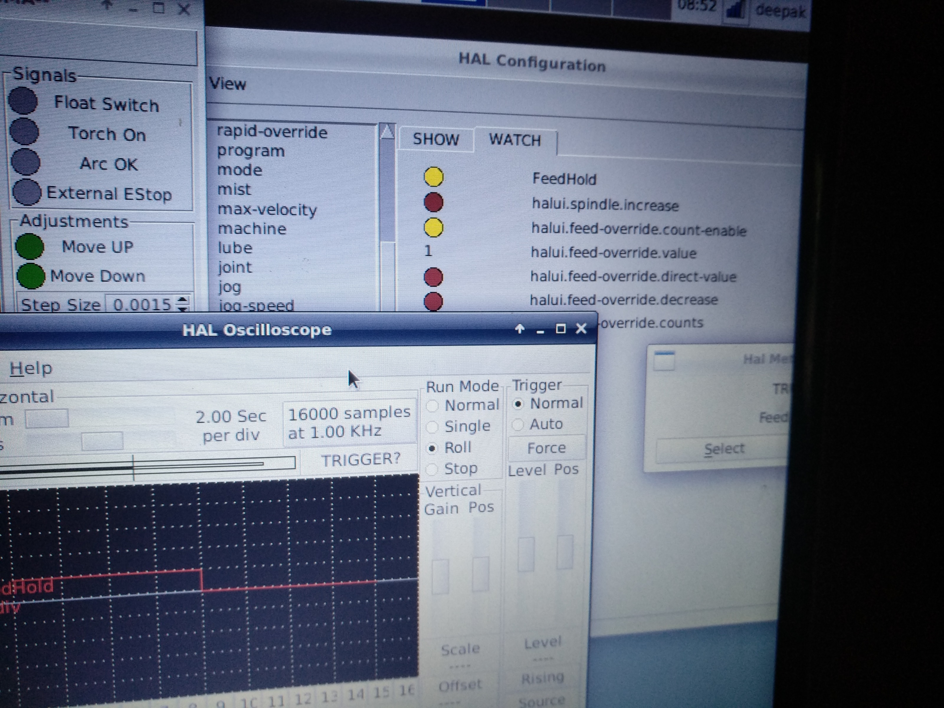

Its just not moving past this line

Do you have anything with "spindle at speed" in hal ?

04 Jul 2019 03:22 #138588 by phoenix
Replied by phoenix on topic Not moving forward in gcode after m3
No sir it seems not
How can i remove this feed hold
What if i send released feed hold from parport output??
04 Jul 2019 11:53 #138616 by andypugh
Replied by andypugh on topic Not moving forward in gcode after m3
What is FeedHold connected to in HAL?

04 Jul 2019 11:56 #138617 by tommylight
Replied by tommylight on topic Not moving forward in gcode after m3
Connect torch on to arcok signals in hal or on the parallel port.
