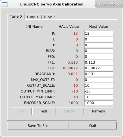

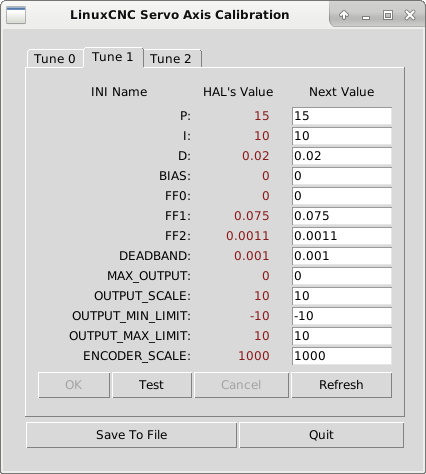

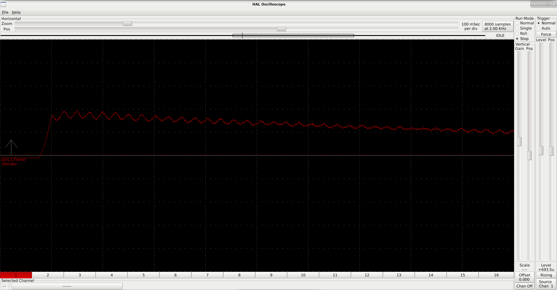

Here are some follow error graphs as well as current tuning parameters for X (which is difficult to tune) and Y (which seems to be performing satisfactorily). Axis 0 is X, axis 1 is Y.
Setting P=0 and commanding a continuous jog produces no movement, and leads to a joint following error eventually, which is what I expected. However, open loop testing in pncconf shows stable movement at low velocities.
X follow error and tune parameters. No oscillation is visible but note the significant constant follow error even during jog, this along with audible noise is the problem.
Y follow error and tune parameters. Oscillation is visible in the graph but system corrects error. Maybe not the best tune. Of course if FF1 ends up helping, this would be good to improve too.

Replied by PCW on topic Odd velocity mode servo tuning issues
If the drives and interface were perfect velocity mode devices, all you would need would be FF1...
For velocity mode drives, FF1 _must_ be right or there is no hope of decent tuning.
Otherwise you will be trying to fix the following error with excessive P term, leading to oscillations
Plotting the commanded velocity would help with interpretation, as would normalizing the
analog output so its in units of velocity, if this is done, FF1==1.0
Normalizing makes all the PID parameters scaled in direct engineering units
The way you do this is by setting the analog output scale (and limits)
to machine units per second at 10V
Last edit: 16 Jul 2019 14:19 by PCW.
Yes, that's correct, for a velocity mode drive, with a position mode PID loop,
the position error *P = velocity _correction_
Note the _correction_, FF1 should have the axis moving at the correct velocity before any corrections are applied. One way to look at this is that the P term is only used to correct for imperfections in the drives velocity following, minor timing errors, interface/drive offsets and resolution limitations.
You might try commenting out this line:
net x-vel-cmd => pid.x.command-deriv
In case its not connected properly on the rest of the hal file
(if that line is commented out the PID component will calculate velocity/FF1 from DP/DT)
