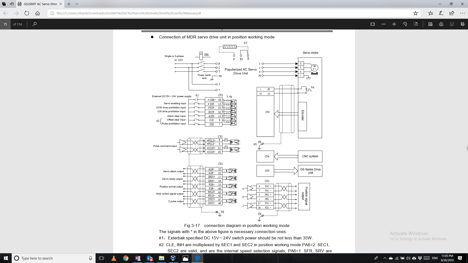

I have cnc milling machine with 3 digital servo and with spindle drive with 0 to 10 analog voltage spindle
x axis drive digital servo drive with ( puls direction) and drive encoder out with A
/A

this drive have only puls and direction in position mode
this drive havent +-10v analog input

What drive is it?

These drives have "position signal output" on the lower right of the drawing, that is a copy of the encoder signals. You can input this to your motion interface to have the loop closed at the LinuxCNC computer.

i wana mesa card with step genarators

You could also consider the Pico-systems cards, or General Mechatronics.
The image you provided (twice) show position control mode, is there a similar diagram for velocity control mode?
If you want step/dir mode, do you still want to use the encoder feedback?
Replied by andypugh on topic linix cnc recrofiting
