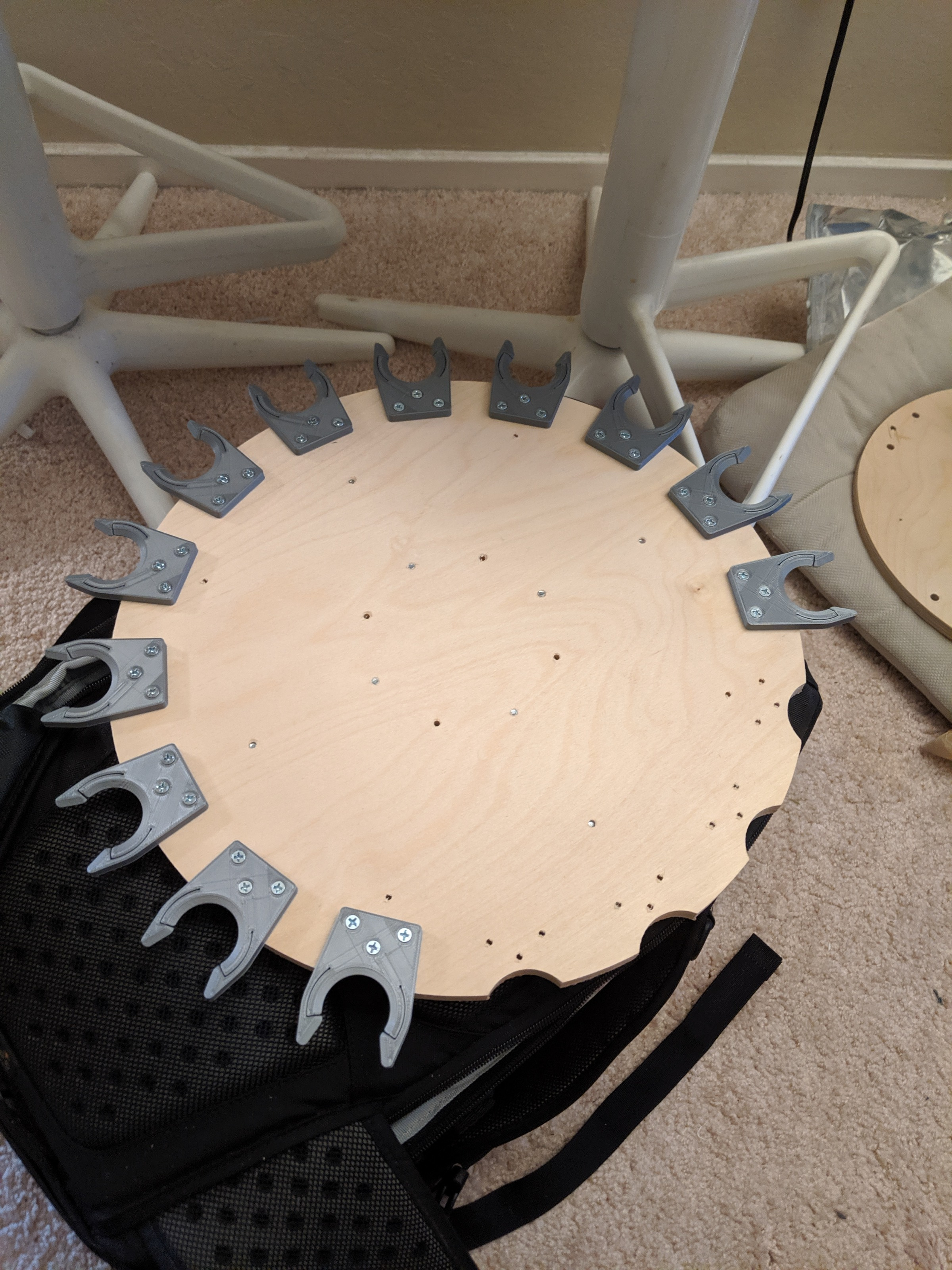

Hi, I have a homemade ATC carousel, I want to drive with a 5i25 card. The rough idea is for every T command, it will call a sub routine that turn the carousel into position x so the spindle can come and pick it up. Is this reasonable? anywhere I can find similar configuration? thanks

when I say x, I meant some position, not x Axis. I'm going to use a break out board, since I already have one, I'm bit confused of the benefit of a daughter board. It's using the same IO as the 5i25 card, and just added butter for the stepping and direction right? I've been using 5i25 for two years now, and never find a need for a daughter card, but my old machine is stepper, the new one is servo, not sure that changes anything

I'm using Mitsubishi MR-JE-100A to drive servo, so lots of ways to drive it. I think dir/step will work just fine, the machine can only reach 1300IPM anyway.
The carousel will only have one homing switch, and the pocket location is defined by steps away from home. I looked at the carousel package, it seems need each pocket to have it's own signal

If you only have a home signal then you should probably configure the carousel as axis A, B or C as a rotary. Then you can home the carousel as part of the normal axis homing sequence and then drive it to positions calculated in a G-code remap.
The carousel component is probably no help with your setup.
Adding some sense switches to give absolute position would probably be valuable, though. You would need 4 more prox sensors and 4 IO lines to detect the 16 positions.
