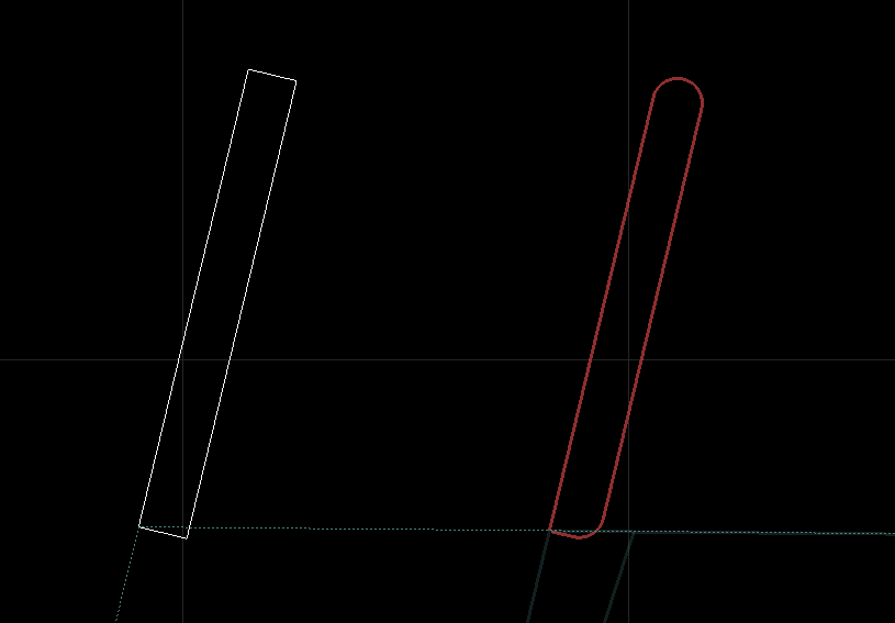

Hi everyone,
I am playing around with CNC systems for some years and am using LinuxCNC for ~1 year now. Today I have a problem I newer realized before:
LinuxCNC doesn't follow the g-code...
The attached image shows a screenshot with the g-code (white) and the way the machine mills the structure (red). I do not understand why the machine doesn't follow the g-code. Did I miss something? I also tried with only 25% feed without success.
The g-code looks like this:
Using
LINUXCNC - 2.8.0-pre1-5206-gb3f7b2519
gmoccapy 3.0.8.2
MESA 7i76e
Thanks for Help!

G00 X20.9082 Y66.4595 Z1.0000
G00 Z0.5000
G01 Z-2.0000 F600
G01 X27.1649 Y92.5446 F1200
G01 X29.9120 Y91.8857
G01 X23.6553 Y65.8006
G01 X20.9082 Y66.4595
G01 Z-2.8200 F600
G00 Z1.0000Using

That is a common mistake of beginners in Linuxcnc.
The default setting for Linuxcnc is G64 with no blending tolerance. This causes the corner rounding you see. Set G64Pn in the preamble of your g-code files, with the n= to some acceptable tolerance.

Thank you!
And: Sorry for that question...
Never realized this before.

I am not sure that LinuxCNC chooses the best default state really.
On some level, if you tell LinuxCNC that your axes can move this fast, and accelerate that fast, then you are really saying (just basic physics) that you understand that corners have to be rounded at high speeds.
But I doubt that many users _actually_ realise that is what they are configuring.
If LinuxCNC defaulted to exact-stop then people would be less surprised, but then the forum would be full of "Why is LinuxCNC so stupidly slow? Even my old GRBL could do better than this".
