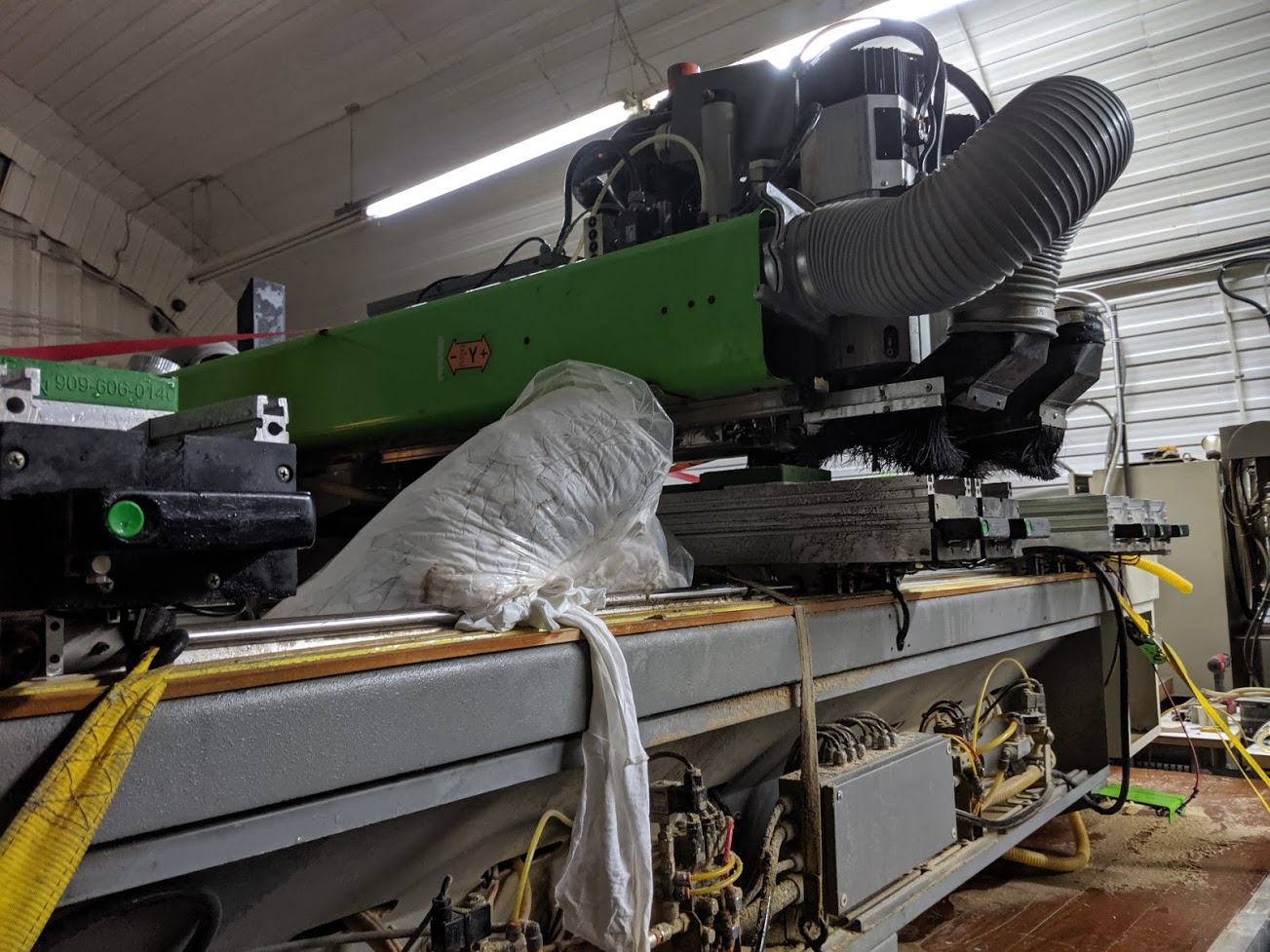

I checked it already. Quad encoders going to the control, DC Servos, PWME drives with tach and +-10v velocity control.
32 remote relays.
Looks like a job for 5i25/7i77 - 7i74 - and two 7i84's.
Same VFD green I have in my other Biesse, icontrol or something like that. Same HSD spindles. so no problem there.
32 remote relays.

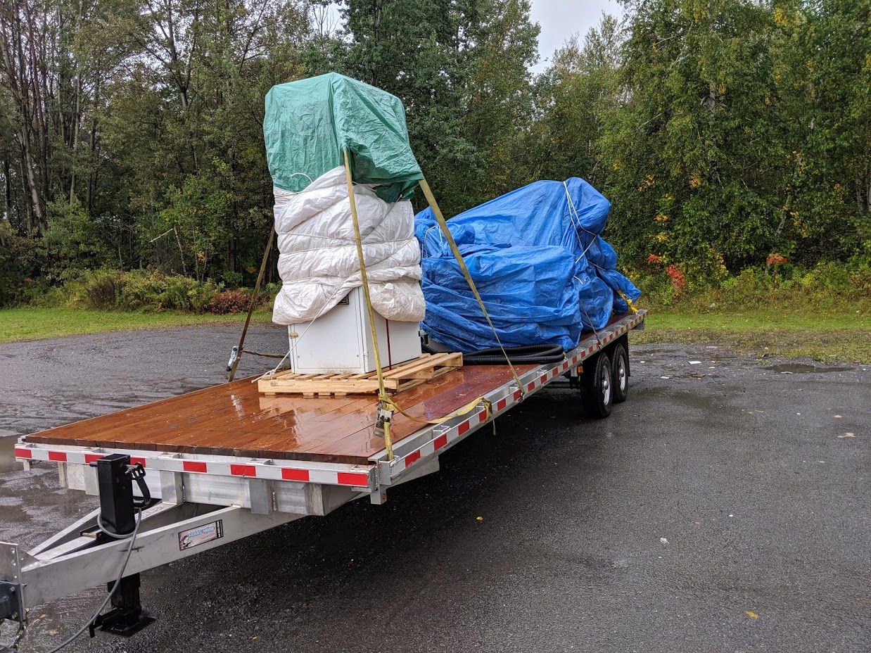

take some time to let the system be temp Neutral
and as well bend to its new location
not that good to travel in a wet invirerment
is it a transport company or like TV Transporter USA Service that got the mashine to you

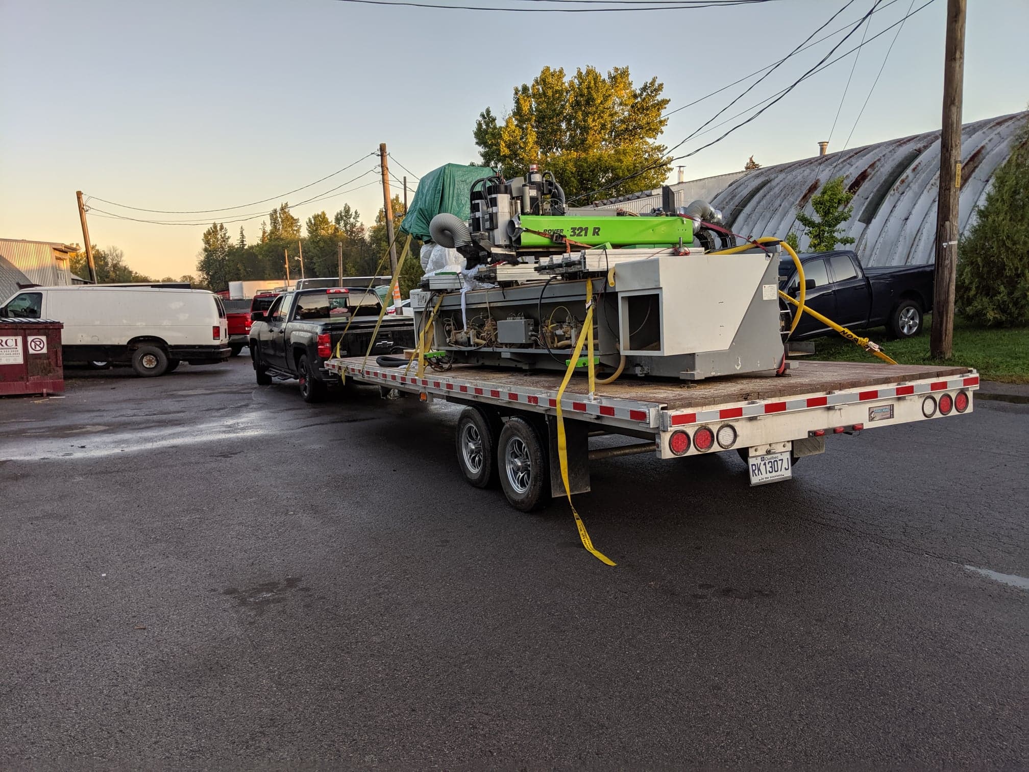

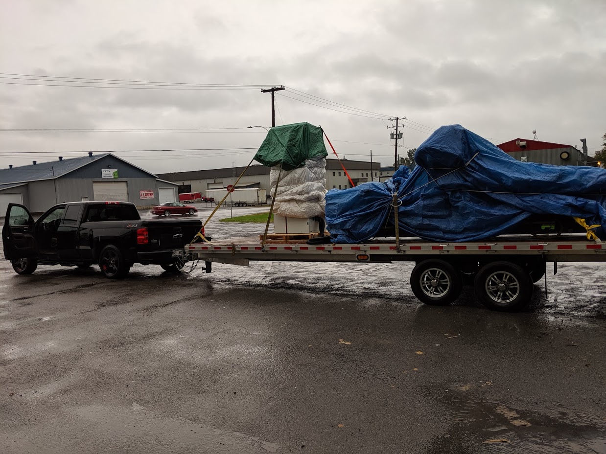

Thats my truck and trailor. I went and got it.
Replied by bevins on topic Bob's Biesse 341 retrofit

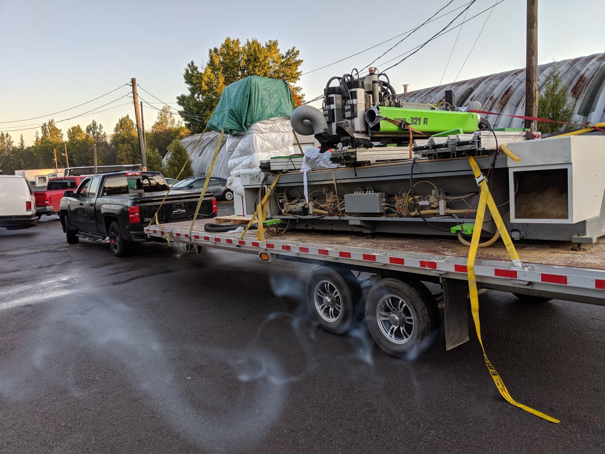

Wait, who's smoking on that last picture ?
- bevins
- Posts: 1947
- Thank you received: 338
27 Sep 2019 12:42 #146374
by bevins
lol, thats me. My lift could not lift the machine. Had to use the lift of my neighbor.
