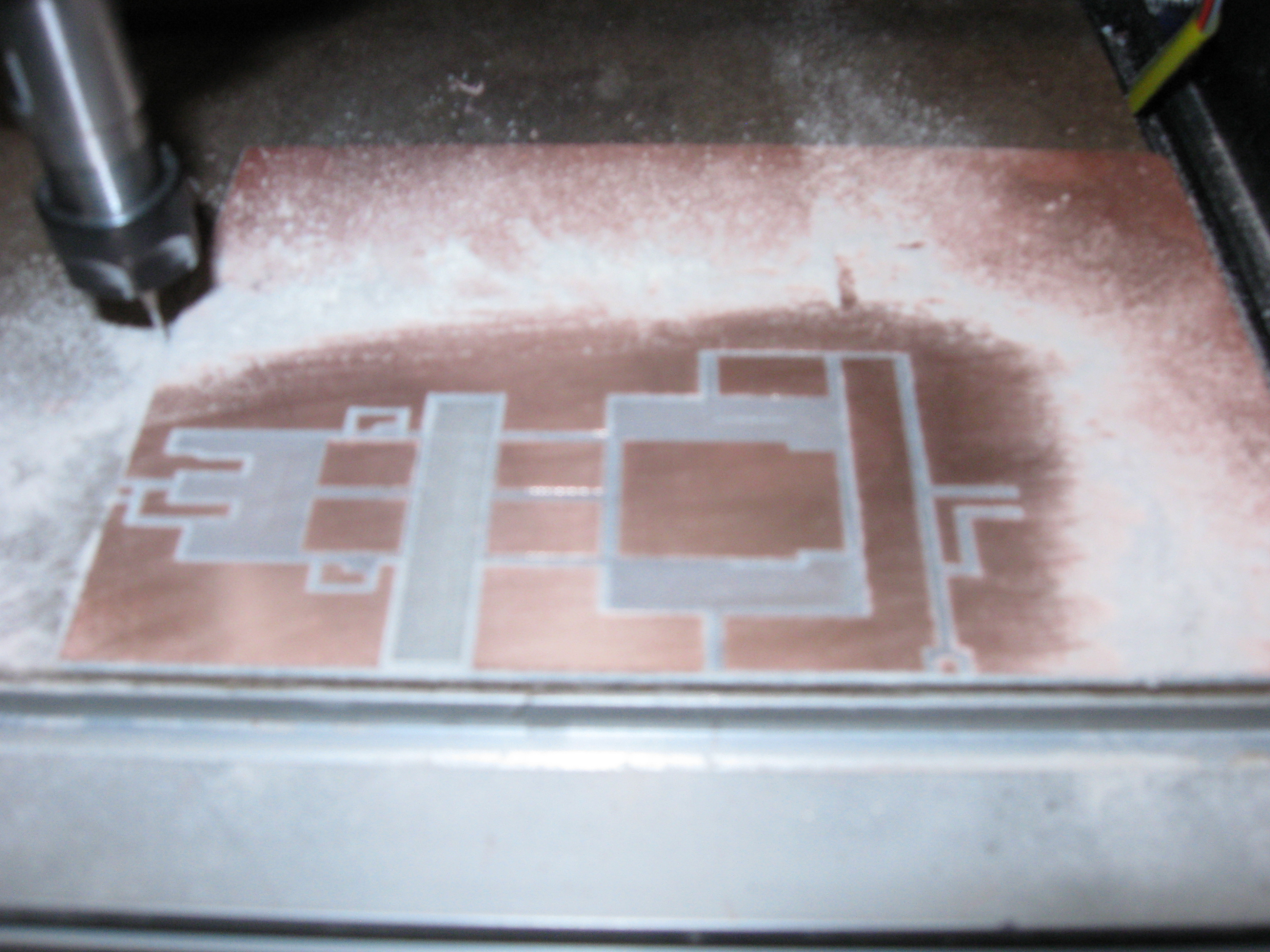

Not much of an introduction here other than I'm slowly warping my mind around a steep learning curve.
So far...
I've been using gimp to edit jpeg , export as bmp , inkscape to trace bitmap and save as svg , jscut.org to create toolpath.
Scaling issues doth vex me :-/
The machine is a
SainSmart Genmitsu CNC Router Machine 3018-MX3, with Mach3 Control
www.amazon.com/gp/product/B07Q27RT32/ref...03_s00?ie=UTF8&psc=1
The computer is Release Linux Mint 19 Tara 64-bit Kernel Linux 4.15.0-20-generic x86_64 MATE 1.20.1 Processor: Intel® Xeon(R) CPU 5160 @ 3.00GHz × 4 Memory: 15.7 GiB Several Tb of Raid6 behind it. An old school hotrod.
So far my kludge is working.
Actual dimensions are approximately 2 inch x 4.45"

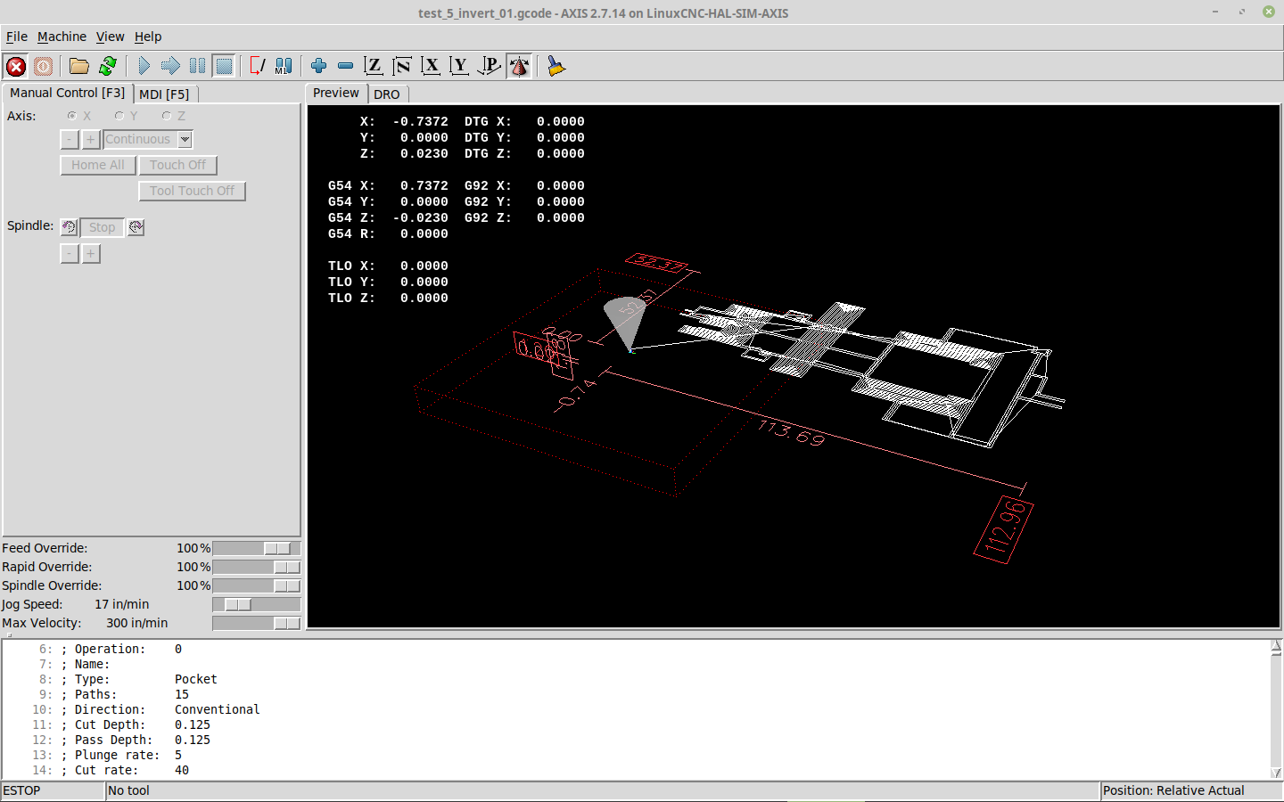

However this is what it looks like in Linuxcnc
Observations: The engraving (aggravating) points supplied were made of kimchi .
Cyful 3.175mm Shank Tungsten Steel Carbide PCB CNC End Mill Engraving Bits Milling Machine 0.8mm Cutting Dia Pack of 10 .
These worked much better
Mach3's demo limitations.
Drufel works but has some annoying omissions. No stop/pause/resume. No ability to start from line xx . The previously mentioned scaling issue. I'm confined to a M$ Win7 CF-30 Toughbook. Nothing against the Toughbook other than it has (:cough:) windows on it.
A levelling method would be helpful. Tremendous understatement.
Did I mention I dislike all things M$ ?

It looks like your scaling is a simple mm to inches conversion, add a G21 to the beginning of your g-code file so that Linuxcnc will interpret the moves as mm instead of inches.
